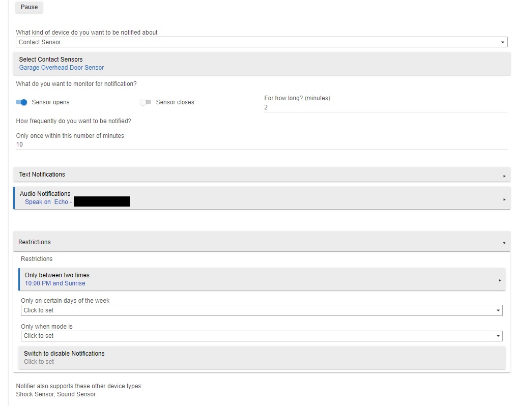

Why not use the notifier app? Sample below.

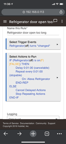

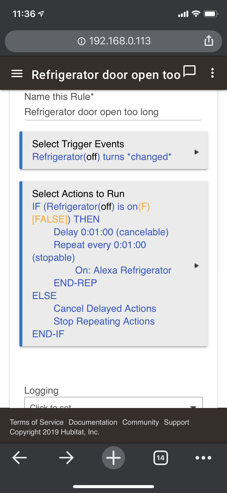

If you want to use RM, here’s how you do the repeat notifications. For me, “Alexa Refrigerator” is a virtual switch that acts like a motion sensor to trigger an Alexa TTS message. This repeats until the door is closed, but you just enter the N repeat value to limit it.

Being the new guy I didn't know there was a notification app ... I just tested it and it works great, but only repeats the message once ... I want it to repeat once every 10 minutes ... I put "2" in the "Onlky once within this number of minutes" field thinking that it would repeat once every 2 minutes ... that was not the case ...

I use this:
