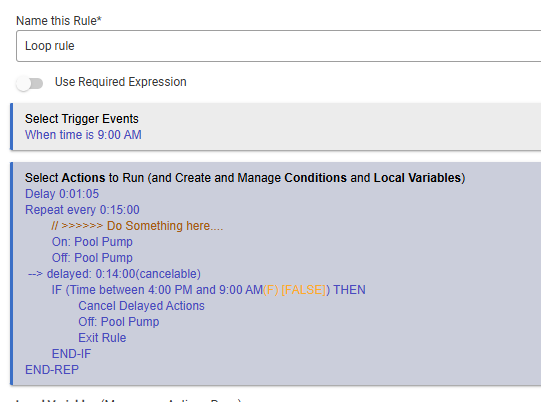

The rule is running but the pool pump is not cycling. Several other things I have noticed.
On my dashboard (on an android) the pool pump is not executing all i get is sending. Then I found something else out . The pool pump is controlled by 1 channel on a Sonoff 4CH Pro running Tasmota.
If I cycle the pool pump nothing shows up in the live logs or past logs. I pretty much dont pay any attention to the HUB unless I need to.
