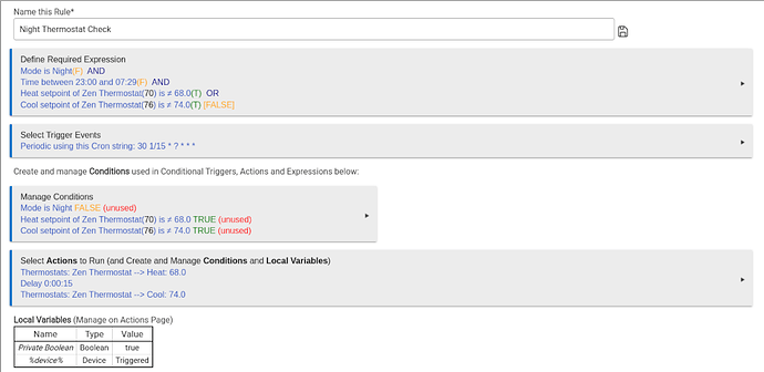

I use this one to check that my thermostat is at the correct setting. It may be of use to you for checking and adjusting the pressure in the bed.
I should add that this rule evolved from earlier rule machine versions to the current rule 5.1 version so the conditions section could probably be eliminated since they are flagged as "unused."
