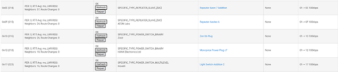

This is what "healthy" connected devices look like
EDIT- so in order to confirm my observation, I just re-paired my ZRC-90. I confirmed the Z-wave details looked good, and validated every button press. I then removed the batteries for about 20 seconds, when replaced the device was still connected and works fine.
