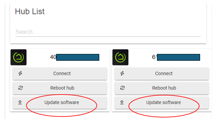

I also found if you launch the update from the remote access web page prior to bringing up the gui the update has a better chance of success.
At one location I have a VPN option to get to hub and wondered if there is a preferred hierarchy to doing updates:
  1. Do from LAN at location of hub (best)
  2. Do via VPN to hub from remote
  3. DO from remote access page update software button b4 launching GUI
  4. do via remote access via GUI and setting menu. (worst)
