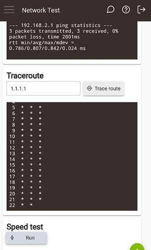

I went into the network test section of the Hubitat hub, and can ping my gateway and 1.1.1.1 with expected latency. I ran a trace route through the hub and got this result. Is it normal to have asterisks instead of ip addresses listed? I've never run a trace route with the hub.
Since the trace ends at 12.1, which is my tmobile 5g modem/router, I'm thinking something is blocking it there. But why? Nothing has changed and it's been working fine for so long.
