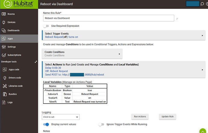

I was thinking I would create a rule triggered by a virtual switch called reboot. I could put the VSwitch in one of my dashboards. The rule would detect the Vswitch set to on, then in the actions, switch the Vswitch off again, and run a reboot() command. I saw reference to a reboot() in older posts but I guess the structure has changed and now I can't find that command anywhere.

Update:
I was able to create a virtual switch that triggers a hub reboot. Simple on/off switch in the dashboard. Then a rule that triggers on the Vswitch turning on, delays a few seconds, turns off the Vswitch, then triggers a reboot.
Required the installation of Hub Information Driver v3 (actually v3.1.9). Then creating a virtual device using this driver. Once the device populates then you must turn on the preference "Allow Hub to be shutdown or rebooted" and save.
Lastly in the reboot rule create the action -->> Send POST to: http://youripaddress:8080/hub/reboot
Best if you have DHCP reservation turned on for Hubitat so its IPaddress doesn't change at the local router.

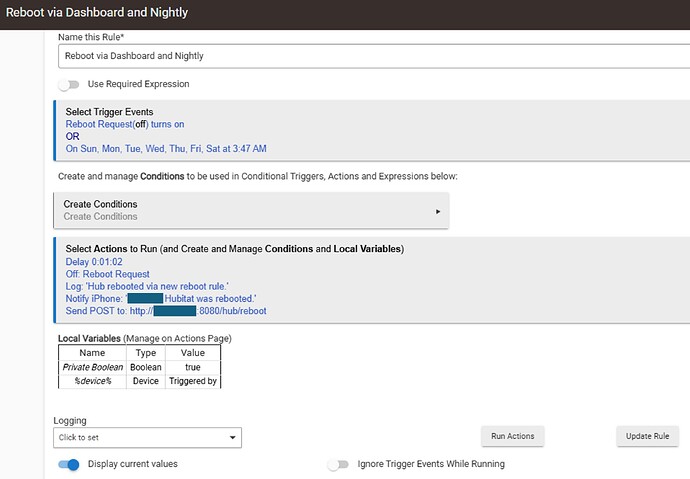

I refined my reboot rule a little. Might not be needed given some of the positive changes in .181 and .182 but I am going to leave it in until I can put a WiFi plug in front of Hubitat.
The rule triggers when either a manual switch on of a virtual switch on the dashboard (reboot Request) or at 3:47AM each day.
The delay is just to eliminate a race condition where Hubitat returns from reboot but it is still the time of day to reboot.
As mentioned before this is based on having Hub Information Driver v3 installed and a virtual device created from it. Lastly the device created must have "Allow Hub to be shutdown or rebooted" enabled in preferences.
