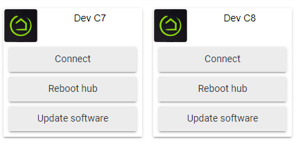

But the Dashboard is working I can turn ON devices. I seem to recall on occasion reaching a screen where I would see all my hubs with remote access as well as a reboot button, can’t find that page.
This is the page you wanted: https://remoteaccess.aws.hubitat.com/
If that does not work you will need to get someone to reboot it or pull the plug for you, then I would suggest updating to the new .184 build they fixed some cloud connection issues and added an hourly cloud reconnect so hopefully people do not get standard with no access again.
Thanks for that. Tried the reboot but was unsuccessful, So yes need to get someone to cycle the unit.
