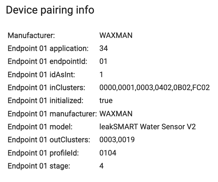

Can you get me a complete fingerprint for the device you have?

Here's the fingerprint output.

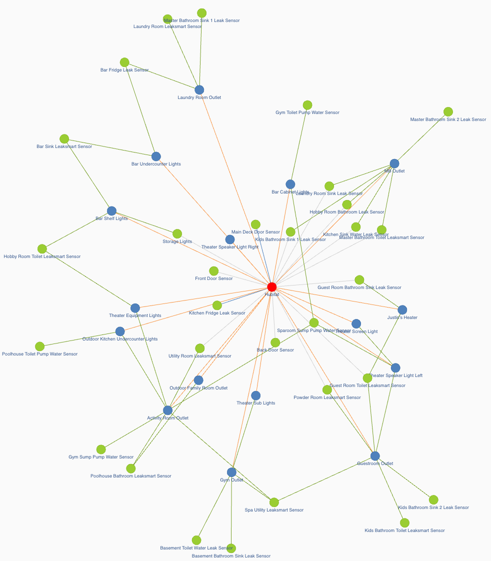

It is definitely possible that my mesh is still not good, though i think it improved a lot with me adding additional repeaters (Sylvania Plug-in outlets),
Here's the breakdown of my zigbee mesh:
total 43 devices (12 are repeaters), which are:

Ok Folks, here's an update. By this point i did the following.
- Added 4 more repeaters (2 more Sylvania plug-ins and 2 in-wall outlets).
- After adding 4 more repeaters and making sure all other repeaters are functioning, i've reset and re-paired every battery zigbee device, at their intended destinations (all re-paired fine, except one leaksmart that looks like maybe failing)
- Shutdown the hub (c8) for 30 minutes.
- After restart waited for 24 hours for the mesh to stabilized.
- Retested all sensors for wet/dry state change.
Here's what the mesh looks like now. Does it look heathy? (to me it looks messy haha), but joking aside, looking at the mesh, for the most part it does look like most of the battery device are now hanging off a right repeater, for the exception of the few. One question is why a lot of them still have a tentative (gray line) line back to the hub?

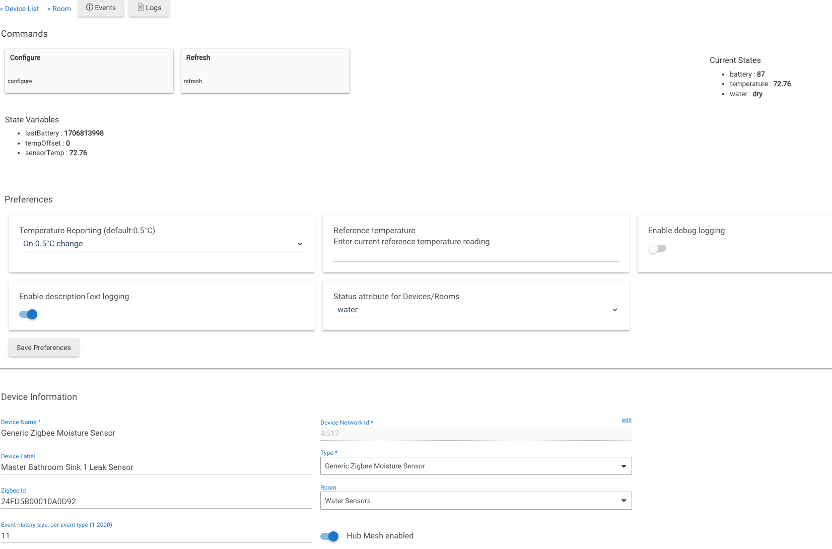

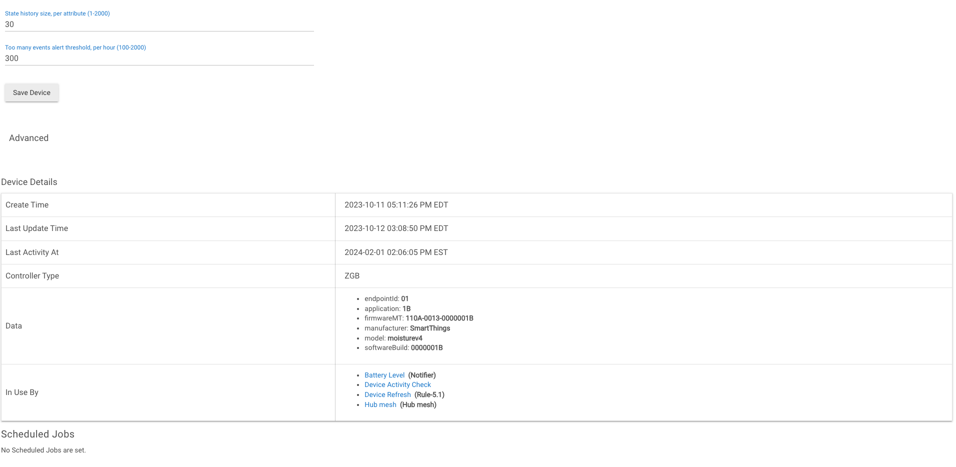

Here are the properties for one of them. All are setup the same, using the same driver.
