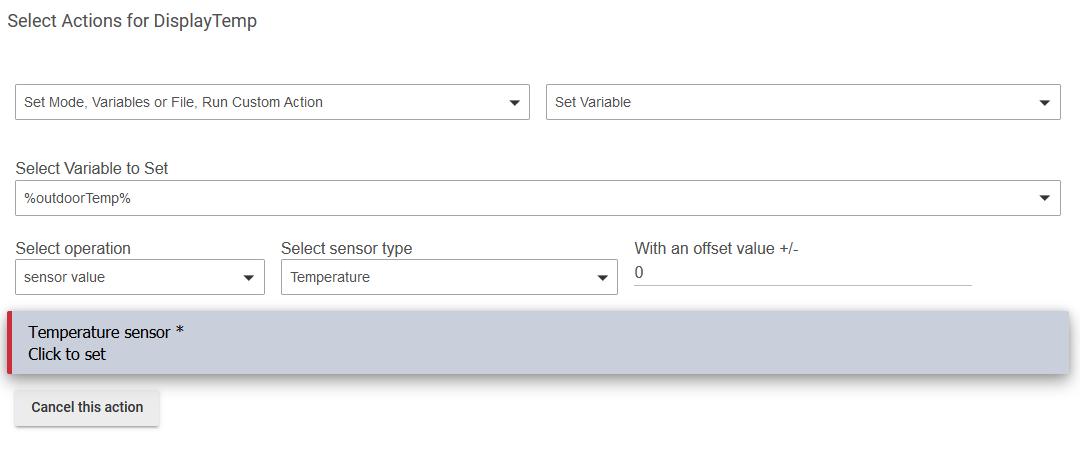

I'm trying to set the value of a local variable from the temperature of one of my devices using Rule 4.0. In the field to select the temperature sensor, the selection panel doesn't open.
FYI, that's the only place I noticed such behavior.
Does anyone know what I may have done wrong or is it a glitch to be corrected in one of the future updates?
It should, I do notice that your variable has the % signs around it. I don't think those should be there. When I select a variable global or local it does not have those around it, it should just show the variable name.
Don't know if that has any thing to do with why your sensor list won't drop, but it looks odd to me.

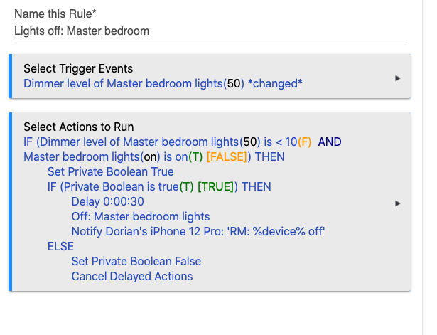

I am having trouble wrapping my head around RM 4.0. I've looked at the examples but can't get my rule to do what I want. This is what Im trying to achieve:
If a dimmer is set to below 10%;
Delay 30 seconds, then turn off dimmer and send notification
If the the dimmer switch is turned off, or the level is set to 10 or higher, during the 30 second delay, cancel the 30 second delay and the off and notification actions.
Here is what I have so far. The problem is that the actions under "IF private Boolean is TRUE" always execute, even when the first IF is no longer true. I think my issue is that the ELSE is attached to the second IF, but I want it attached to the first IF. I can't figure out how to outdent the ELSE to make it apply to the first IF, not the second IF.

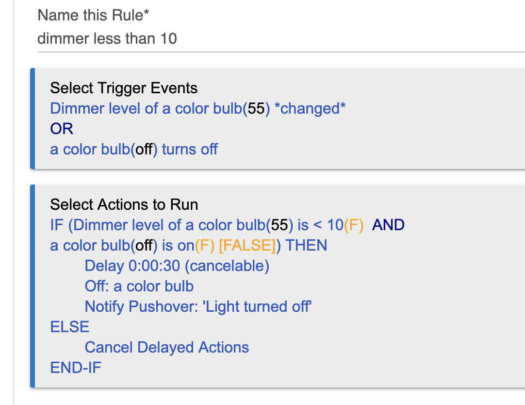

You need to have both the dimmer changing level and the switch turning off as trigger events since either can affect the outcome.

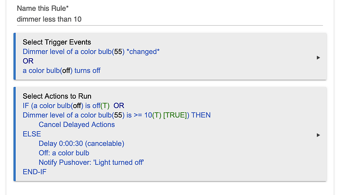

We know that if the first IF is false, that the switch is on and its level is less than 10, since if either the switch was turned off or its level set to 10 or higher, that the IF would be true.
Thank you @bravenel appreciate you replying. You flipped the IF and ELSE around from what I had, which seems counterintuitive to me. Is that necessary or just personal preference?
I started the way you did, but ran into the issue about the switch being turned off. So, it could be done that way too, just testing that the switch is on.
