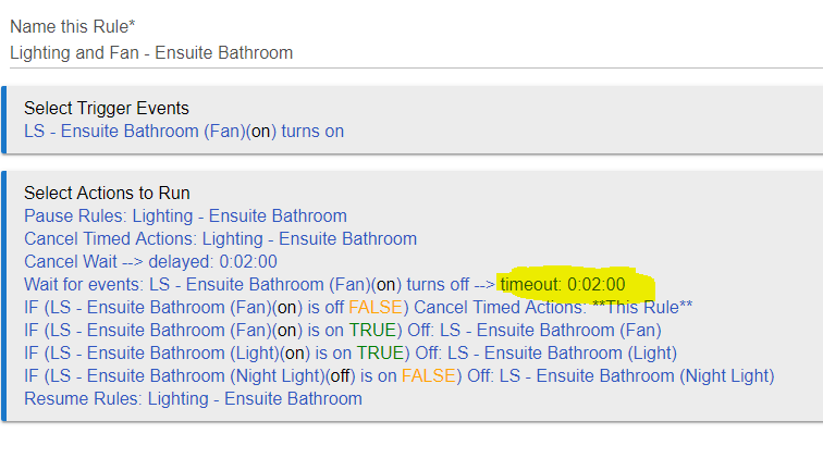

Thanks. I tried this, and it didnt turn off. Should "cancel wait" preclude the rest of the rule (after the wait) from running. If so, what is the correct command?
I want the 3 lines to run after the wait is over, OR if the wait is cancelled. The others are superflous.
My questions are:
Cancel wait is for the case where the event did not occur.
What is the timeout in yellow doing? Why did my first rule above not work, when that was not included? Do you need both timeout and cancel wait for the event not occuring?

To answer your question, you don't need both a cancel wait and a wait with a timeout. The timeout (the part in yellow) is what makes the wait "expire." Your "cancel" is, at best, not doing anything (in an ideal world it happens at the same time the wait would have ended anyway due to the timeout) or at worst cancelling the execution of both the remainder of the wait and everything after it (this seems more likely to me: being before the wait, I'm guessing it's more likely for this delayed cancellation to run a few milliseconds before the wait's own timeout actually runs out). Like a standalone "Cancel Delayed Actions" (if you are familiar) on a standalone "Delay" action, a "Cancel Wait" action will cancel both the wait and everything after it.
The general paradigm you're looking for to wait for either an event or elapsed time and then proceeding with different actions depending on which happened is this:
Wait for events: XYZ turns off --> timeout: 0:02:00
IF (XYZ is off) THEN
/* do things here you want to do because the switch turned off */
ELSE
/* do things here you want to do because the timeout elapsed */
END-IF
So you wait for the event, then check a condition that would have resulted from that event--here the switch being on or off. If it's off after the wait, we assume that the wait event happened (though technically a "Wait for events" based on that would also catch it if the switch already happened to be off in the first place and then the timeout just happened to expire). If it's on, the ELSE runs, so it must have been the timeout that made the wait expire.
PS - In related news, I know you didn't really ask for help with your rule, but it looks a bit messy. Does the switch report multiple sprurious "off" events if already off, i.e., is that an issue you're trying to solve with an on trigger and pausing/resuming this rule based on that? If not, you could use an off trigger and get rid of all these waits and just do what you want then, unless there is more complexity to this elsewhere.

This rule: Lighting and Fan - Ensuite Bathroom
Another rule: Lighting - Ensuite Bathroom
I'm attempting with this rule to have the fan turn off after 20 minutes of turning on, and also turn off any lights that were turned on by the other rule (which would have already triggered, since it's wholly based on motion). So, as soon as I press the fan button (activating this rule), it pauses the other rule (which is auto off after 5 mins), it cancels the other rules timed actions, and then after the 20 minutes expires in this rule, it resumes the other rule ready for next time.
