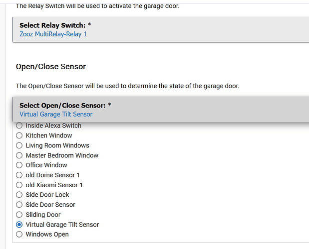

I've got a hardwired contact sensor that I connected directly to the inputs of the MultiRelay. In order to use that as the contact sensor for the garage door opener, I had to make a Rule that mirrored the status of those inputs to a Virtual Contact Sensor. Which works, but seems unnecessarily kludgy.
Is there a simpler way to do this that I'm missing?

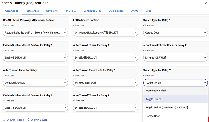

I'm not sure what screenshot you want. Here is the Preferences tab from the Device.
The opener is Relay 1. The contact sensor is connected to Relay 2. Relay 2 only has an option of being a Garage Door or Switch.
Relay 2 isn't an option to choose for the OpenClose sensor in the app.
40960 is the ZEN16, and you have v1 unit which was before they added the ability to separate the input from the output, and also adding the various extra input types.
So your solution of using a virtual contact sensor mirroring the on/off state of the R2 is probably the best way to do it for your model ZEN16
