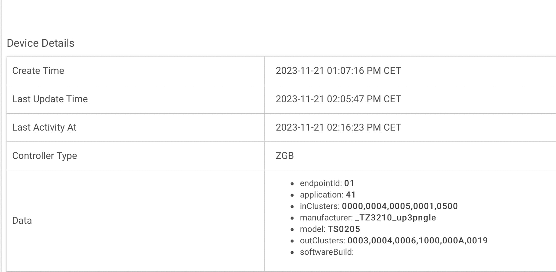

Please post the full Zigbee details, including the Zigbee manufacturer ID.
  • endpointId: 01
  • application: 44
  • inClusters: 0000,0001,0003,0500,0502
  • manufacturer: _TYZB01_wqcac7lo
  • model: TS0205
  • outClusters: 0003,0019
  • softwareBuild:
@simon 's driver should be working with this device.

The driver currently supports the following Tuya TS0205 smoke sensors:
TS0205 _TZ3210_up3pngle
TS0205 _TYZB01_dsjszp0x
If it works also with your device, we can ask Simon to add the new fingerprint into this driver as well.
