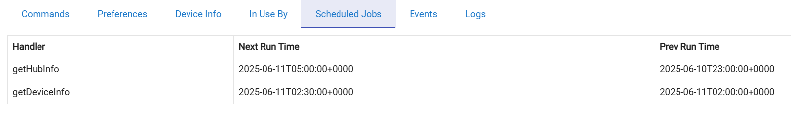

This setting allows you to turn the scheduled data collection on and off when you are using the driver on a dedicated Zigbee router. If your network was stable you might just leave it off most of the time and only turn it on when you wish to do some troubleshooting. However, if you want the Zigbee data updating regularly then you should leave it on.
When it is in the on state you should see some jobs.

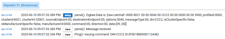

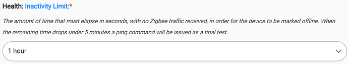

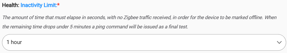

You can look in the State Variables area to see the time of the last Zigbee activity.
If there has been no Zigbee activity for Inactivity Limit
then it will attempt to do a ping when there is 5 minutes remaining (Set Log Level to Debug for this output)
That should give you some tools to debug your issue.
