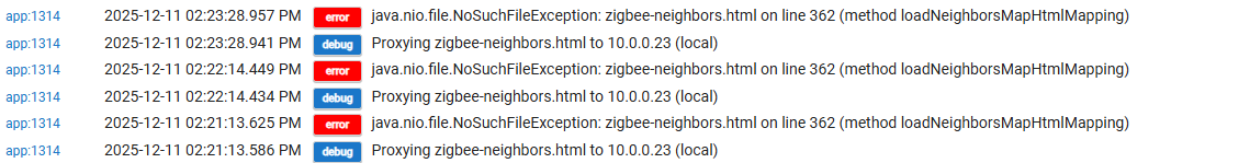

I just tried to install this, but it not working for me either. I installed from Package Manager and there was no app in the list. I added it as a user app, and I got the app screen, but nothing works, it brings up a browser page with an error for everything.
Uninstall though package manger also failed. It said it removed it and everything was still there. I deleted everything manually. I guess I am not trying this app as it clearly has issues on my C8.

Looks like Package Manager did not copy the files to File Manager, for whatever reason.
Which apparently is the unexpected error I get in the browser.
{"error":true,"type":"java.lang.Exception","message":"An unexpected error occurred."}
No updates available for Package Manager, so I don't know why it didn't copy the files.
I guess I can download the files from github and upload them to File Manager myself, but I'm not going to bother since I have no immediate need for this app. Not worth the hassle.
Edit: Looks like package manager broke at some point, I think that explains it.

I just deleted Package Manger and reinstalled it.
Zigbee Map is now working. Package Manager had been passed through several hub migrations, I guess it just got corrupted at some point.
