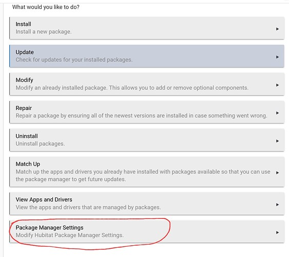

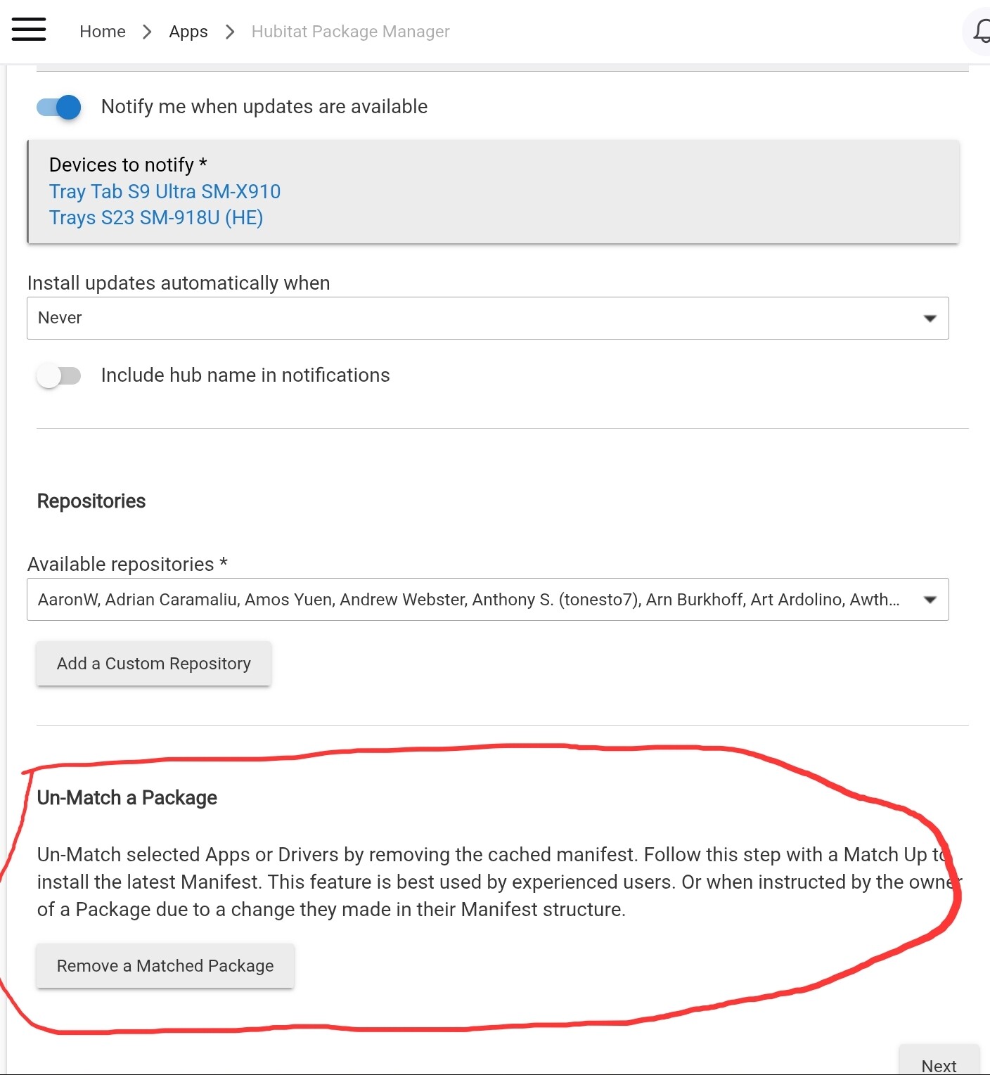

Try "unmatching" then run a matchup
Summary
What if you just delete all the Zigbee map app, driver, driver code and app code for it and then a "repair"?
I suspect it's missing the driver/app code and is trying to delete something that doesn't exist which is the failure.
Thank you very much. I tried this but it did not work. Thank you so much for trying to help.
Thank you very much. This took care of the issue. I done the unmatch then the matchup and now when I go to uninstall it only shows the one Zigbee Map.
