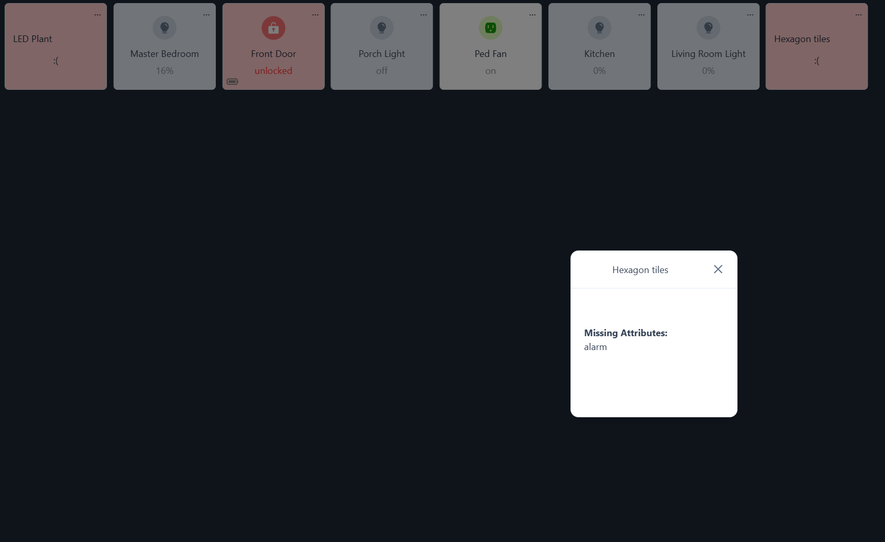

Having an issue adding a couple of WLED lamps I've made. used your driver but I keep getting this error. Any help would be appreciated.
Got it to work on regular Dashboard but not Easy Dashboard so no big deal at this point.
