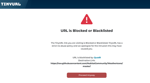

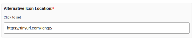

Matt, You might want to check your tinyurl link, I think it is being blocked.

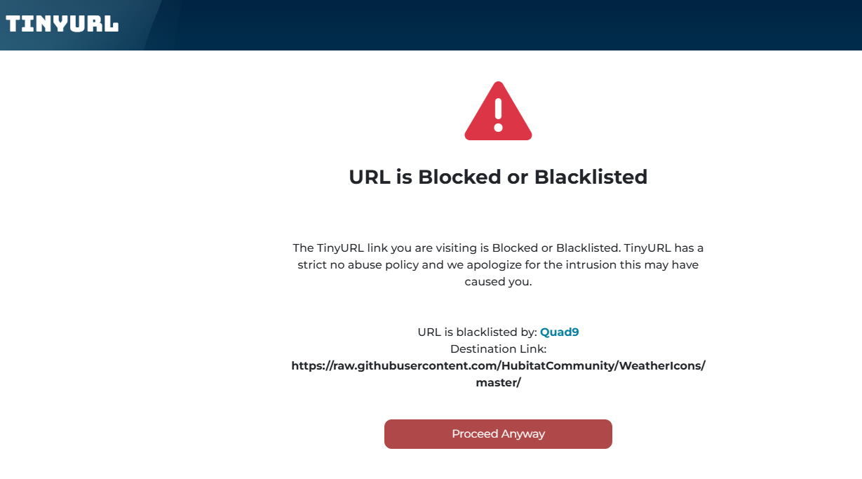

This link fails:
Result when I click on the icon:
I submitted a ticket to tinyurl.com requesting that the block be removed.
UPDATE: it appears as if the destination has been flagged as 'Blacklisted', so you cannot create another tinyurl that point to that same location. I tried another service (tinycc) it said the destination was also blacklisted. Again, you can copy all the icons from that location to a destination of your choice and change the Alternative Icon Location in the preferences to map to that location.
Nothing in the code has changed recently. The platform is adding in a closing double quote to the end of the link, and I don't know why? I have been unsuccessful in getting that to go away. You can right click on the link and 'Copy Link', then paste that into a browser and delete the closing double quote and the link does work then. Same thing is happening with the icons. I pointed the 'Alternative Icon Location' to server location I can access and they are not showing on my dashboard, but if you right click and select 'Copy Image Link' and paste that into browser the image shows?

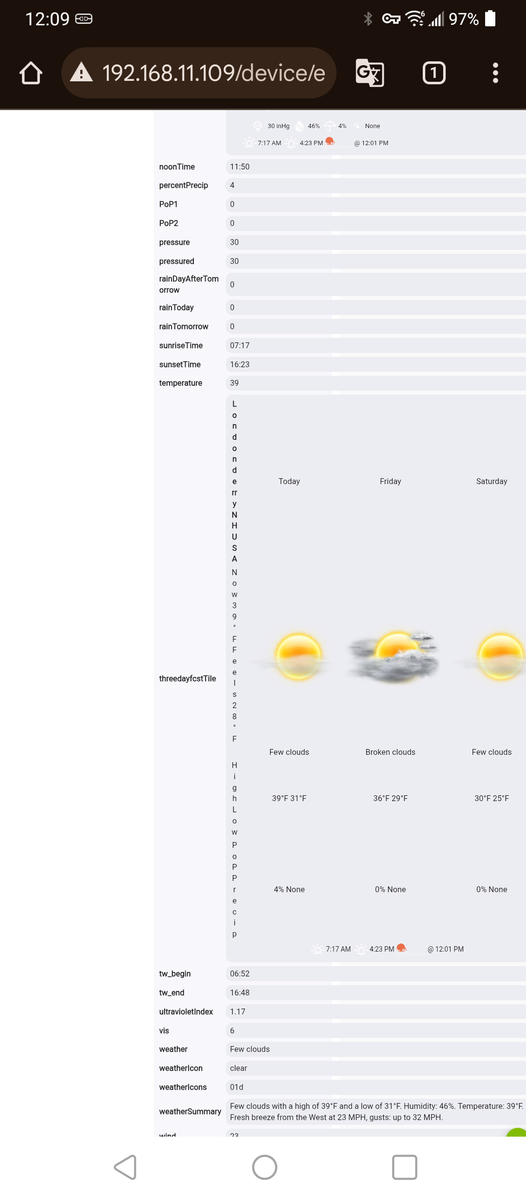

My images are displaying fine..but current forcast which combines images and text is not..

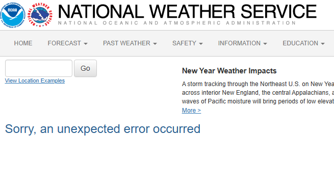

There is still an issue if you are using NWS for weather alerts. On the Alert Tile there is an extra double quote appended to the link, so when that is clicked you get an invalid site error. You can go into the URL in your browser and delete that trailing double qoute and the link should work. I have not been able to determine how to prevent this .... yet.
