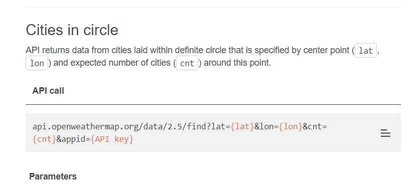

Found an OWM api that returns the city code. Perhaps run it when the user saves preferences, then store the id in an @field or whatever, using it as part of the link when it's available. Will need some error logic when nothing is found or it fails.
Setting cnt to 1, Returned following data where id is the city code
{"message":"accurate","cod":"200","count":1,"list":[{"id":5100924,"name":"Martinsville","coord":{"lat":40.6,"lon":-74.56},"main":{"temp":292.26,"feels_like":293.21,"temp_min":290.37,"temp_max":295.37,"pressure":1025,"humidity":93},"dt":1603300395,"wind":{"speed":2.6,"deg":170},"sys":{"country":"US"},"rain":null,"snow":null,"clouds":{"all":90},"weather":[{"id":804,"main":"Clouds","description":"overcast clouds","icon":"04d"}]}]}
Updated URLs in the dashboard tile hyperlinks to take you to a OWM location specific page for details, including any weather alerts. This update attempts to use the specific city code found by the latitude/longitude coordinates. If no city code is found (or returned) then it will use the generic site URL which will use your geolocation (if available in your browser), or , you can input your city to search. (Thanks @arnb)

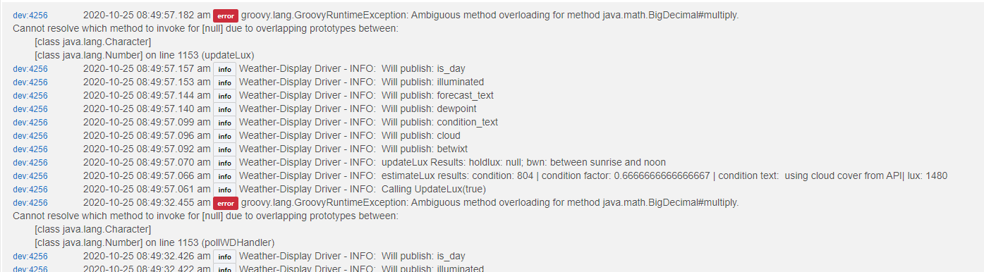

Try updating the code again. I apparently didn't copy the latest code when I published the latest update, but did so later. In the current code line 1153 is a blank line, so I think you may be on the previous version. If you are using HPM, do a 'Repair'. Otherwise, recopy the code (or 'Import') to get the latest version. Let me know if you still see an error.
I appearently didn't copy the latest code to Github when I posted V0.2.9. Anyone who updated prior to me correcting that actually just updated to V0.2.8. I highly recommend that anyone who has already updated to V0.2.9 re-update. If you use HPM do a 'Repair'. I you don't use HPM, open the code and do an 'Import', than save. This will ensure you are on the latest code.
