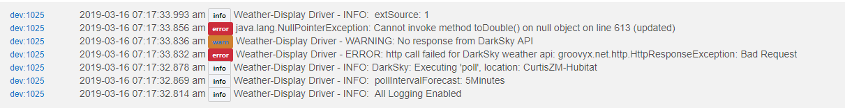

Alright, got a bit more. Nuked device and recreated.
Seeing:
[dev:20](http://10.0.6.4/logs/past#dev20)2019-03-16 09:59:00.222 pm [error](http://10.0.6.4/device/edit/20)java.lang.NullPointerException: Cannot invoke method toInteger() on null object on line 378 (updated)

Then your json-webservice-wdlive is not delivering the forecast.icon.code to the driver. You need to figure out why that is. Open a new browser tab and type in the full everything.php URL to pull the data and see what forecast.icon.code is. see excerpt of that below....

I think you need to figure out why the json-webservice-wdlive is giving null values. That is not expected. Can you trace those back to the clientraw.txt? Are they null (or do not exist) in that file too?

maybe I miss-understood but I am just trying to use this driver to only pull weather data from DarkSky
not sure what the purpose for the setting Station Data File Location: *
When we already select the external source and the api key and the location in the preferences.
I suspect this is where I am misunderstanding
Is this only to be used in conjunction with an external weather station?
The old Apixu driver works fine I just wanted to try darksky out.
