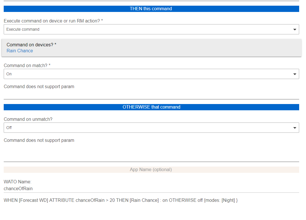

no. i cant see any obvious reason for it. please share the event subscriptions for that WATO.
thanks. when was the last time that device published the chanceOfRain event and what was the value it published?
also added support for logging the received event. please update the child app to the latest and set logging on in settings for this WATO.
Does this work now? having trouble getting it to work for me.
It is very low today. I'll have to see later this week. I have it set for 50%. I was really trying to have WATO look at alert. Once a watch or warning occurred, it would turn on a virtual switch.
