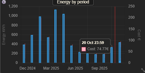

You can change the graph type from "line" to "bar" with the following User Script:
$config.type = 'bar';
Bar charts look best when the graph has few datapoints though.

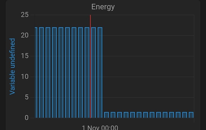

Ok thx. It's in the right way. But my device is updating only one a day and your app is still creating new points each 5 min and because of this, I can't see only one bar per day. I tried to create a second watchtower app to disable this updates but doesn't looks possible.
Maybe there's a magic script as well?
You can set the chart to show the 1d time resolution and save the dashboard. It will remember to load that chart at the same time resolution.

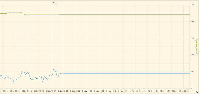

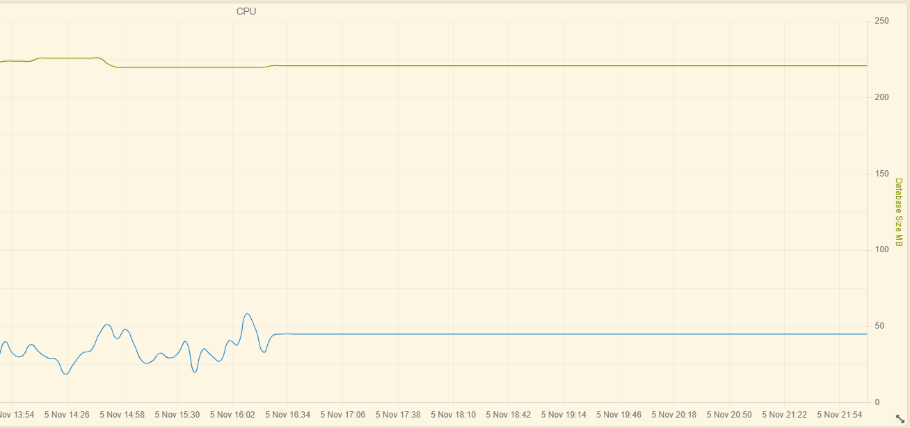

Ever since I updated HE to 2.4.3.151, I am getting this error from watchtower 4.0.0
and my cpu dashboard that logs cup load and db size has not changed and is static

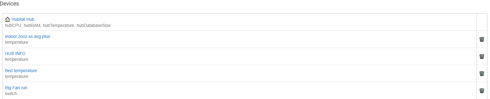

In watchtower, I cannot delete the hubitat hub as there is no trashcan icon to click on
Vats goink on?
I don't mind deleting the cpu dashboard but I can't.
That's a beta release BTW.

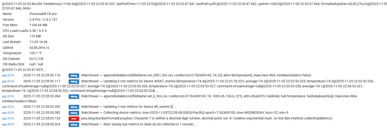

@dandanache looks like the /hub/advanced/freeOSMemoryLast endpoint finally is getting its header fixed (and a new "Direct Java" column added) making the code in collectHubMetrics() fail in this version. Now looks like below. :
Date/time,Free OS,5m CPU avg,Total Java,Free Java,Direct Java
11-06 06:07:14,1537268,1.86,331392,237557,295

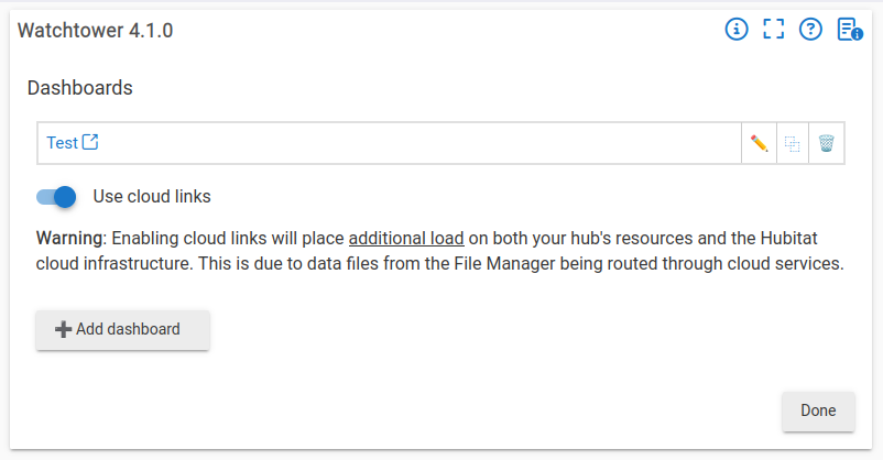

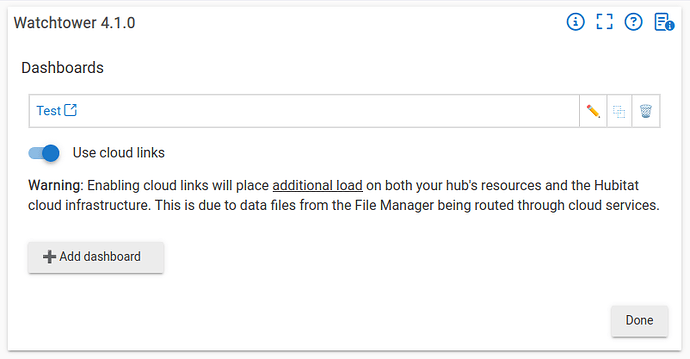

  • Add option to proxy dashboards via Hubitat cloud infrastructure - @antti202

Other point, I don't know why, but now my bars have a lot of space between each one. I'm trying to get rid of them but my script is not working properly. I had some electricity outtage that caused issues on my hub and maybe something happened with WT?
I have two series and each ones have only one measure each month.
$config.data.datasets[0].categoryPercentage = 1.0;
$config.data.datasets[0].barPercentage = 1.0;
$config.data.datasets[0].barThickness = 6;

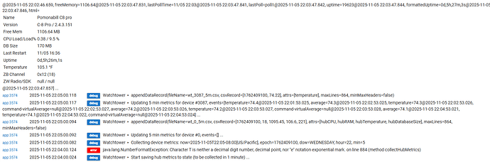

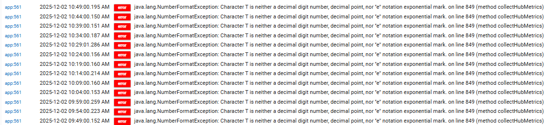

I am now seeing this error since I updated to release 2.4.3.164. May have been there before but my logs only go back to the last reboot of the hub that was during the update to the new version.
It seems to be related to collecting Hub metrics.
app:18972025-12-01 12:14:08.787 PMinfoWatchtower 3.0.0 has been updated
app:18972025-12-01 12:14:00.095 PMerrorjava.lang.NumberFormatException: Character T is neither a decimal digit number, decimal point, nor "e" notation exponential mark. on line 849 (method collectHubMetrics)
app:18972025-12-01 12:14:00.024 PMdebugWatchtower ▸ Start saving hub metrics to state (to be collected in 1 minute) ...
app:18972025-12-01 12:12:48.493 PMdebugWatchtower ▸ Returning Hub information
I had missed the need to un-match, and then match to get beyond version 3.0 of Watchtower, sorry.
Note: I moved the code from GitHub to a nicer location, I hope this won't cause any problems with HPM updates. In case of problems, first backup your hub to make sure you don't lose any WT csv files, then mess away with HPM (un-match, match-up, etc.).
What I think I have figured out is the new release has added some additional headers in the hub/advanced/freeOSMemoryLast call, and this is causing the error.
Here is mine now:
12-02 10:03:50,1154672,0.7,331392,168281,4906
I have modified my app for now until @dandanache gets a chance to fixing this.

I sometime get these errors too immediately after restart, some endpoints (like /hub/advanced/internalTempCelsius) are not yet ready at hub startup. You can safely ignore these errors.
In order to keep the source code smaller (initial target was max 1000 lines of code, but went past that a while ago) I skipped some error checks where I believed it was not important.

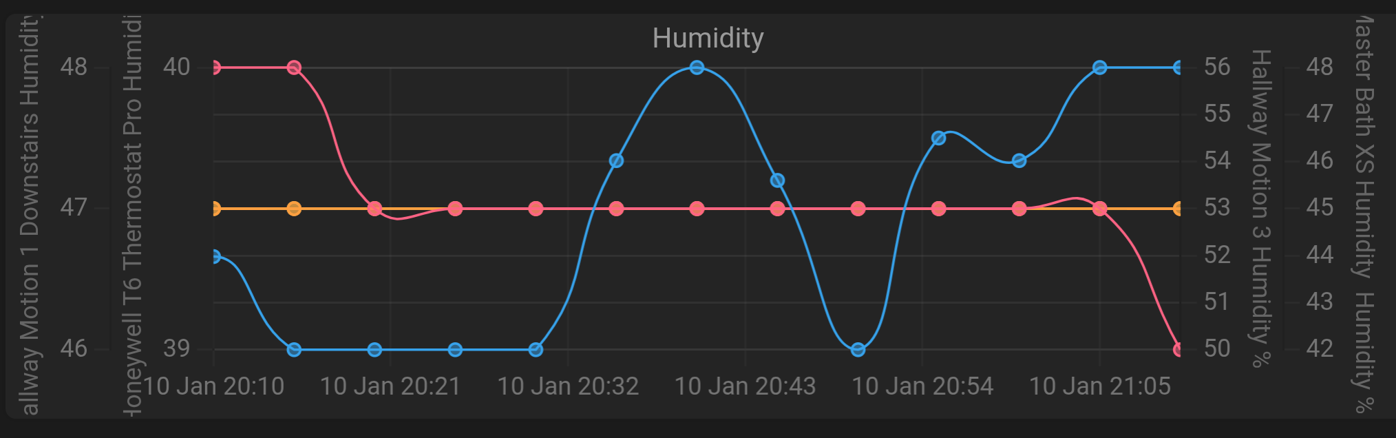

I'm noticing something on my end that I'm not seeing on others. When using multi device attributes, I am not getting the color coordination on the labels like others. The labels are also nested along the y axis - not sure if that's intended. Ideally there could be a legend underneath the graph, is that possible with the JavaScript?
Thank you for the kind words and for the coffee :metal:
From your screenshot it looks like you’re charting humidity across four devices. For that setup, the Single Attribute tile type works better. It should also take care of the label issue.
You can add a legend by using the Chart user script feature. There's an example in there that shows how to enable it. If you want to tweak things like position or alignment, you can use the standard Chart.js legend options: Legend | Chart.js.

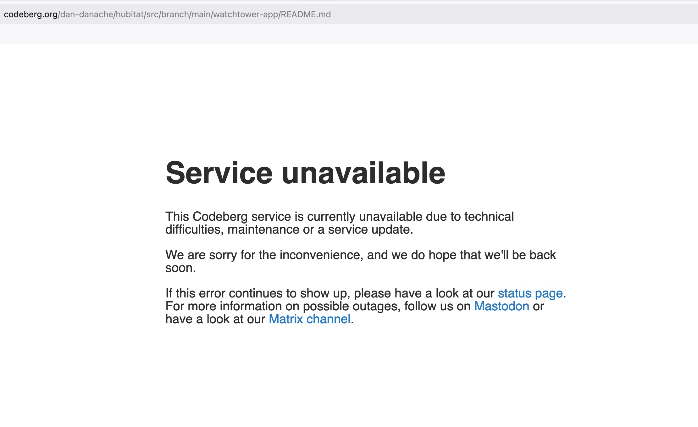

When I click on the "Readme" link, I get this:

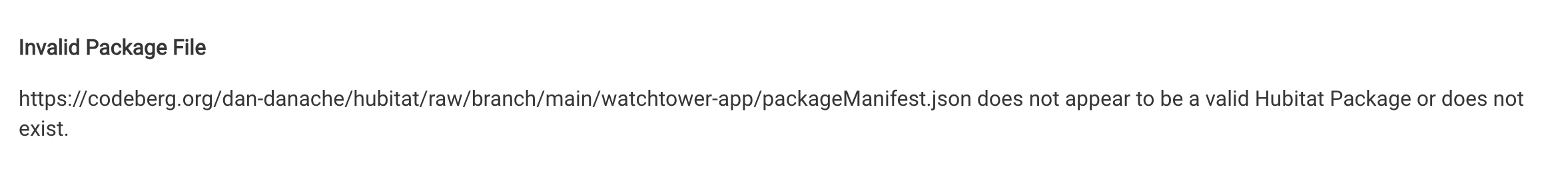

Error when trying to install via HPM.
The json exists, as I can open it in a browser.

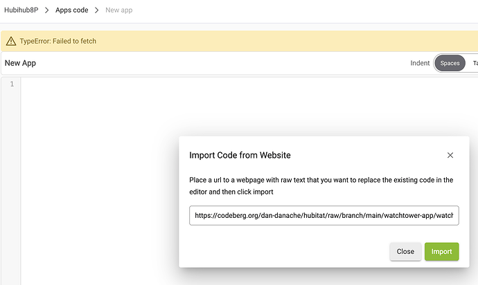

Manual import as per the manual instructions, also gives an error:
However, copy/pasting the code and saving works.
It's probably Anubis weighing the soul of your HTTP requests and finding them wanting :slight_smile:
