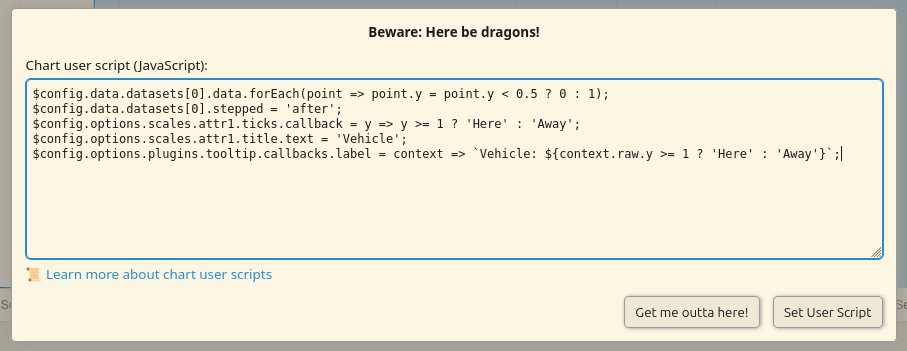

However, without changing the way you store data, is there some way to apply a rounding function to the 5 minute interval data when graphing the data, so that, for example, a percentage from zero up to 50% is displayed as “zero“, and any value from 50% to 100% is displayed as a “one“?
Everything is possible with the User Script feature :rofl:
  1. Create a Single Device chart
  2. Select just the attribute you want to chart (with values between 0 and 100)
  3. Add the following User Script:
    $config.data.datasets[0].data.forEach(point => point.y = point.y < 50 ? 0 : 1);
    $config.data.datasets[0].stepped = 'after';
    $config.options.scales.attr1.ticks.callback = y => y >= 1 ? 'Here' : 'Away';
    $config.options.scales.attr1.title.text = 'Vehicle';
    $config.options.plugins.tooltip.callbacks.label = context => `Vehicle: ${context.raw.y >= 1 ? 'Here' : 'Away'}`;
    ^ The first line is "rounding" the chart data. Rest of the lines are cosmetic: use right angles for the chart line, change scale values (Here, Away) and name (Vehicle), change tooltip text.

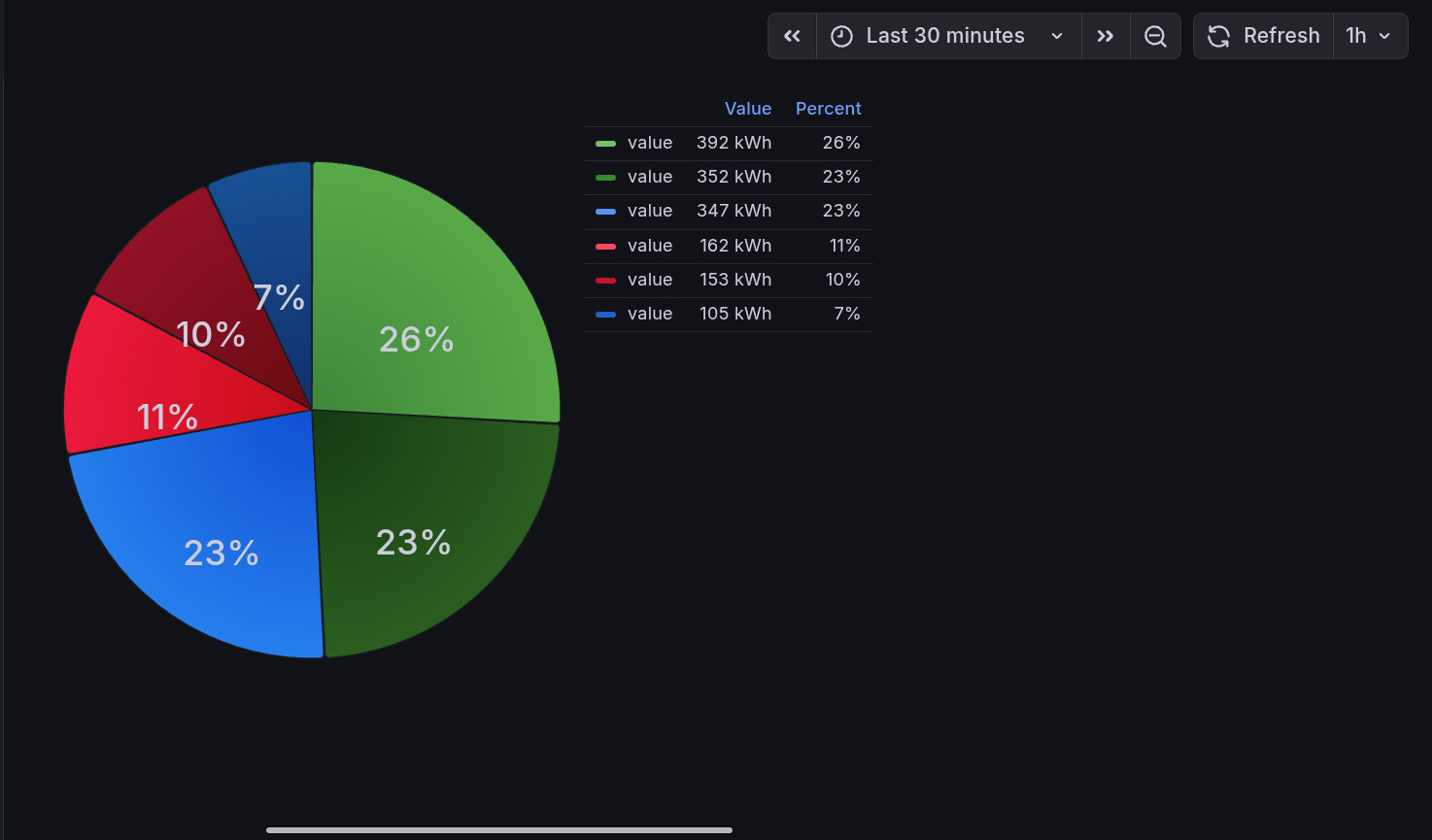

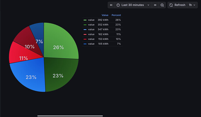

Hello. Can you please advise me how to make a pie chart for the energy values ​​of the device? Thank you for your help.
I haven't implemented pie charts in Watchtower yet, mainly because I didn't have a personal use case for them. That said, I can explore this idea further if it proves useful to others in the community or if there's broader interest.
Could you share a bit more about the use case you had in mind? Understanding how you'd like to use pie charts for energy data could help shape a potential implementation.

I would only like to display the consumption ratio of individual devices in real time

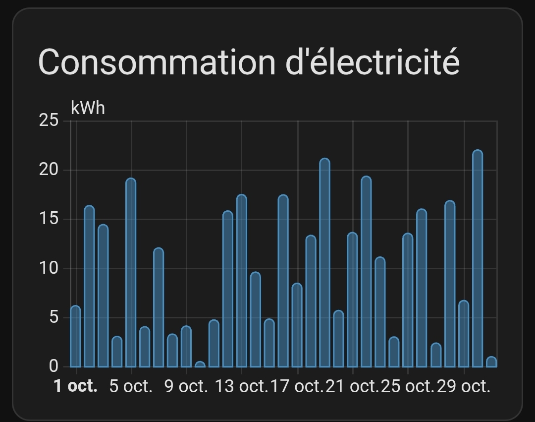

Hello,
How can I do to have a bar graph like this?
I saw one post speaking about pixels but I don't understand exactly how should look the datas.
A dayli bar would be amazing :slightly_smiling_face:
Regarding long-term history converting to bootstrap the database, I managed to do it with power query and some formulas but yes, it took me 2 full days to make this! :dizzy_face:
