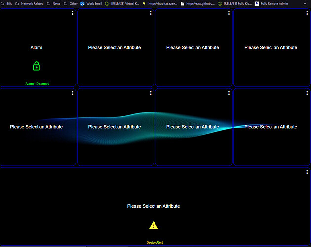

Just thought I'd share what I'm doing this app.
Each function button that is HSM related has the same icon that that status has and it's a dimmed down color of it also.
The HSM tile has a clear text tile over it to prevent interaction with it.
Just under that is a virtual contact sensor linked to open if any of the monitored sensors is open. I sent the open state background color to the same as the closed state text so it "turns off" when it's not ready.
The gap down the middle is the chime device. It goes green down the whole middle. I plan on playing around with adding a second one over it that flashes red during entry delay.
I'm also going to use the display at the top for other status stuff.
