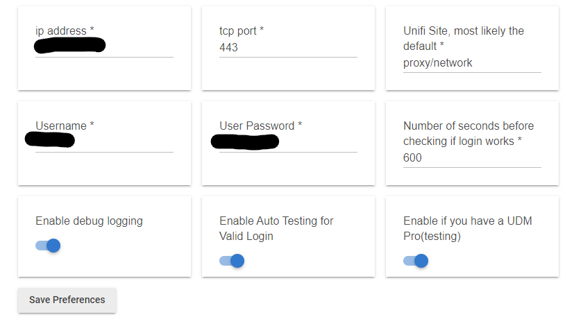

Can someone with a UDMPro test with the latest version and see if they get a valid cookie?
You may need to change the site name to "proxy/network"
Basing this off of the API documentation.

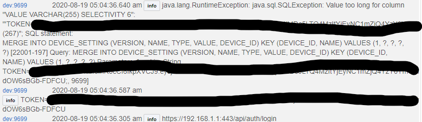

This is the response I got after trying the newest version with UDM Pro running the latest firmware/controller 1.80-rc.16/6.0.13.
Using the default port resulted in an error, but 443 seems to have solved that. I tried both default and "proxy/netwok" same results.
I'm getting the same response as @halfrican.ak :
java.lang.RuntimeException: java.sql.SQLException: Value too long for column "VALUE VARCHAR(255)":
yeah that must be an issue within hubitat my guess is the logging function, because I am not doing any SQL within my code.

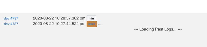

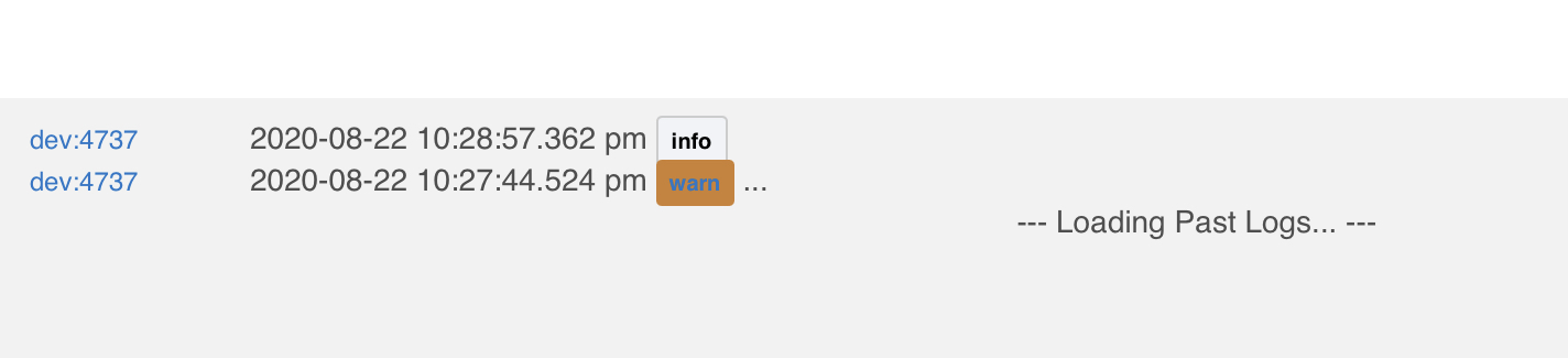

So I updated to the latest code and I seem to be making some progress. I have the same result as @halfrican.ak (which I guess is fine), but on my devices I don’t see any logs.
This is what I see on my child device to block when I hit ‘Get ClientID’.
To get this to work for me I had to put the code between "site/" and "/dashboard" in the url of the web GUI into the "Unifi Site, most likely the default.*" field of the parent device.
Example controller url: https://xxx.xxx.xxx.xxx:8443/manage/site/site code/dashboard
Once I did that everything worked.
