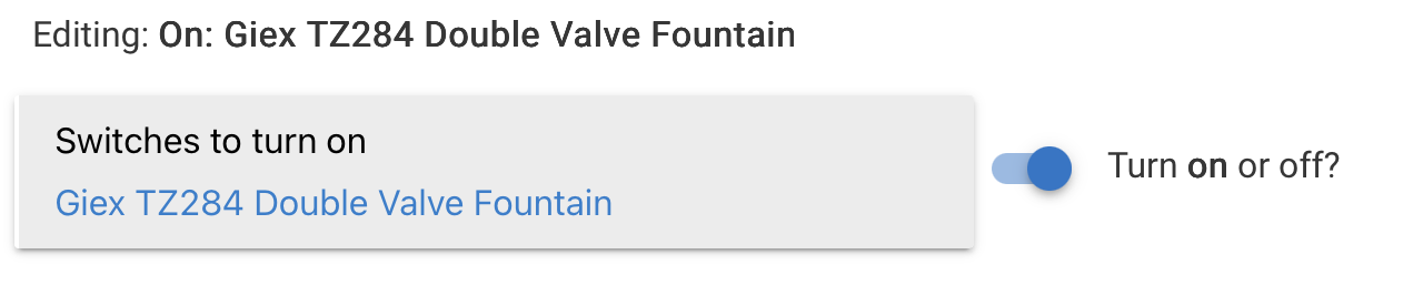

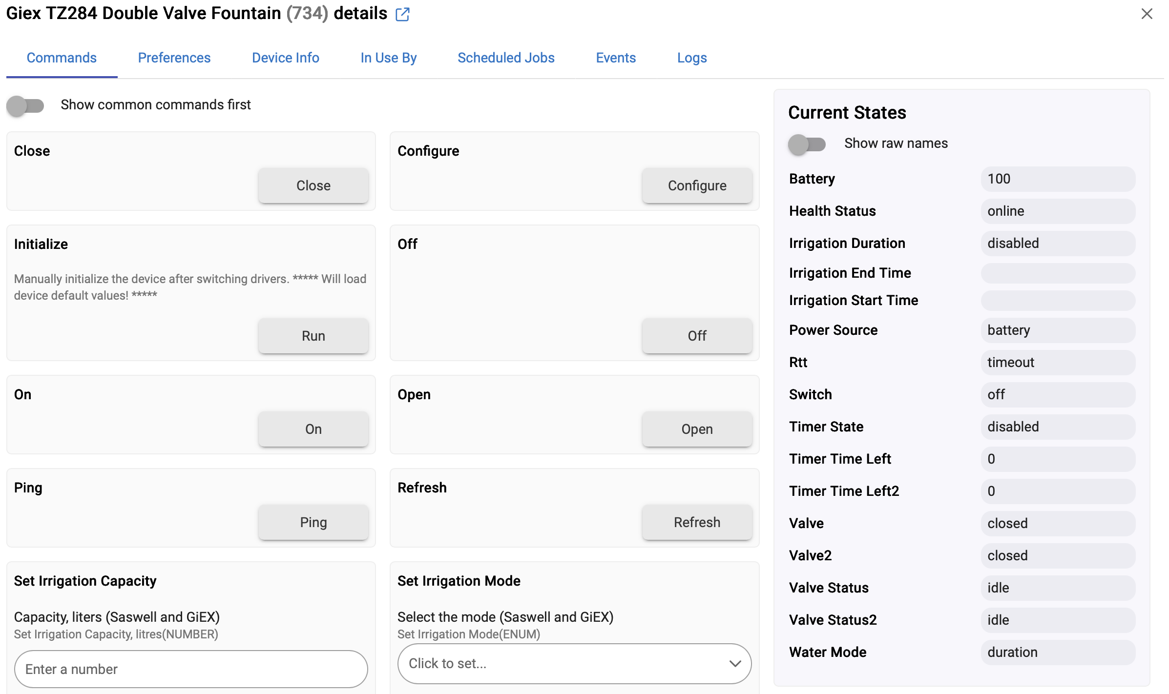

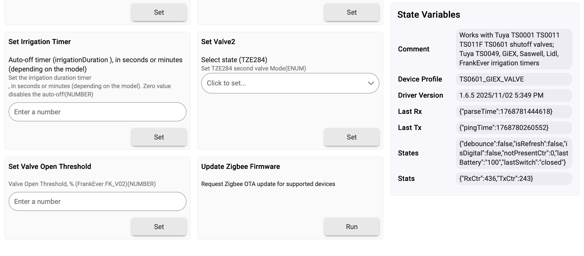

Hi @kkossev! Thanks for the controller than can handle my new "GIEX ZIGBEE 2-Zone Sprinkler Timer GX-03"! The open/close works on the 2nds valve and the "Set Valve2" doesn't do anything - or I don't know how to work it... (the 2nd being the right hand valve)...
I'm using rule machine for my "2nd" valve...which command can handle the 1st valve?
Thanks!
ps: I bought and returned the HAOZEE cos it wouldn't reliably work using the GIEX device controller. Now I have the GX-03 which I assume is the one that works.
Thanks again!
Jann
ps: here's my settings:

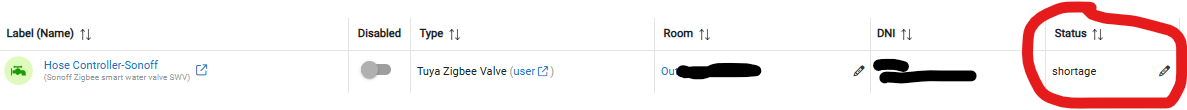

I've reconnected my Sonoff valve to my Hubitat, and am trying to understand two things:
  1. In the device list, I have "Valve Status" selected for the status column, yet it returns "shortage". What in the world does that mean??? I'd like it to show if it is open or closed...
  2. In the "Current States" there is a field for "Rate" yet no matter what, mine shows 0. Does the Sonoff not measure the flow rate?
You should select the 'valve' attribute to see the open or closed status in the device list.
'valveStatus' is a diagnostic attribute sent by the device, and 'shortage' means that for some reason the device does not detect the water flowing... :thinking:
My Sonoff valve is connected on a splitter on an outside tap, one side feeding a hose and the other side feeding my irrigation through the valve. I use the "shortage" state to trigger an alert to let me know that the tap has been inadvertently turned off. I only discovered this "shortage" state after noticing my garden bed was not doing too well and investigating on Hubitat. It transpired that someone (me) had turned off the tap days earlier and my soil sensor battery was flat. Good job I have all this smart stuff to offset my incompetence.

Hey @kkossev, Any chance of getting dual valve Giex's working (GX-03)? I use this with my GX-03 and it controls only the 2nd valve (I think - #2). It's the right one. But I don't know how to control the left one. The rule machine only shows one device (image below) but I need the other one to operate as well.
Any ideas? The GX-03 says it requires tuya hub so I thought this would work...
Thanks!
Jann
OOPS: I see this link from @leepearson1977
So I will try that! Stay tuned!

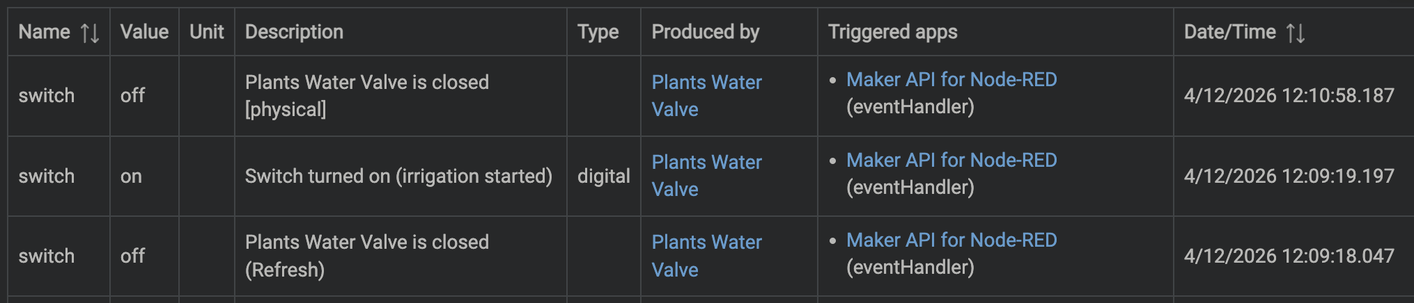

I have a SONOFF SWV Zigbee 3.0 Smart Water Valve using this driver.
I had noticed that quite often the 'valve' and 'switch' states would be incorrect for some time. I have an audible alert when this valve opens, so it was very easy to notice.
The valve is closed now, and if I hit "Refresh" on the device page, it changes to the correct state: valve = closed, but about 1 seconds later it changes again to 'open'. The after ~1½ minute it goes back to the correct state: 'closed'.
It was physically closed all this time.
It also occurs 'randomly', without hitting refresh, it turns to 'open' without any command when in fact it is closed.
I was a bit lazy and asked an AI to analyze the problem :slight_smile:
The bug is in cases 500D and 500E on the switch inside parseSonoffCluster().
The forced sendEvent() calls should not be there. The timestamps should only update the timestamp attributes.

After updating these code blocks, when I hit refresh there are no events, which is expected, because it didn't change any state.
Thanks! I just set up my Sonoff valve with this driver and ran into the same bug. Not quite sure what the intent of those lines are (maybe they're an intentional backstop, but they don't even check if those times are in the past), but I think part of the issue is a bit of a race condition. On a Refresh, both cases are triggered: the irrigationStartTime case sets the valve to open (because it was closed), but the irrigationEndTime doesn't set it back to closed (because it happens too quickly for the open to have registered). Removing/commenting out those lines works for me.
Another small bug that may or may not be specific to my device: the firmware on my valve (I just updated from 1.0.3 to 1.0.4) reports as 00001004 instead of 1.0.4. So I had to change the sonoffMinVersion check from 1.0.3 to 00001003 to get the driver to show the auto shut off config.
Otherwise the driver is working great! Thanks @kkossev!
@eduardo and @kdb - thank you for the reports! I think that I have found the possible root of the problems - refreshing the 0x0006 on/off cluster when the device is performing a timedOn will prevent the valve from automatically switching off! When I skipped reading the 0x0006 cluster attribute 0x0000 in the refresh() method, the valve now auto-closes as programmed. Sounds like a Sonoff firmware bug ...

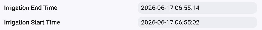

I just installed this driver to use with a couple of Sonoff Sprinklers and I noticed the irrigation start and end times are off by - 4 hours. My hub time and time zone are both correct and the timestamps in the logs for this device are also correct. It’s just the irrigation timestamps in the variables that are incorrect.
Using this driver with Geix GX02 valves, I noticed the same; from observation, the internal clock starts at 00:00:00 when the batteries are inserted, with no way seen to set/reset it.
I wound up writing a wrapper rule that saves off the actual start and end times.
Yeah, I essentially did the same thing using variables. I created a start and stop variable set in webCoRE based on the on / off state changes instead of using the device’s start and stop times.
Good to know WC is fine.

Sorry, this driver is not suitable for controlling double valves.. A simple on/off for the second valve could be possible, but not the full functionality (no auto shut-off, etc..)
I should have checked here first! I have a SONOFF SWV-ZF2E arriving later today, having just “assumed” that it would work okay with HE.
Does this mean that one valve can be used with this driver and it works as planned, and the other valve will do nothing at present? Or could I control the second one with simple on/off? That would be a start, at least.
