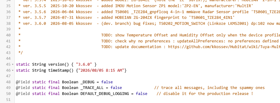

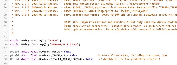

Hi @jshimota ,
Update to v3.6.0 (dev branch), it should fix the following issues :
Raw driver file: https://raw.githubusercontent.com/kkossev/Hubitat/development/Drivers/Tuya%20Multi%20Sensor%204%20In%201/Tuya%20Multi%20Sensor%204%20In%201.groovy
  1. Wrong driver on re-pair (Human Presence Sensor / no response from Device). Your unit's newer firmware pairs with a different cluster list than the original ZG-204ZL entry. That fingerprint is now added, so a fresh exclude and re-pair should auto-select this driver again. The driver has to be saved on the hub before you pair, since fingerprints are only read at join time.
  2. Lux threshold resetting to its default instead of holding 250. Save Preferences had a bug where some preference writes, including sensitivity and keep time, were not actually reaching the device even though the UI accepted them. That is fixed, so the threshold should now stick.
  3. Repeated illuminance in the logs and the duplicate attribute. Your sensor reports lux twice, once over the Tuya datapoint and once over the standard Zigbee illuminance cluster, about half a second apart. The driver now uses only the Tuya datapoint for this device family and ignores the duplicate, which should cut the log noise roughly in half.
  4. Illuminance reporting frequency. There is a new Illuminance Interval setting (1 to 720 minutes, factory default 1 minute) that controls how often the sensor itself sends a lux reading. Raise it if you want fewer reports. It only gets written while the PIR is awake, so trigger a motion event right after saving it.
After updating, please first set your lux threshold and Illuminance Interval again, then re-pair (without deleting the device). Let me know if the driver sticks and the log volume looks better.

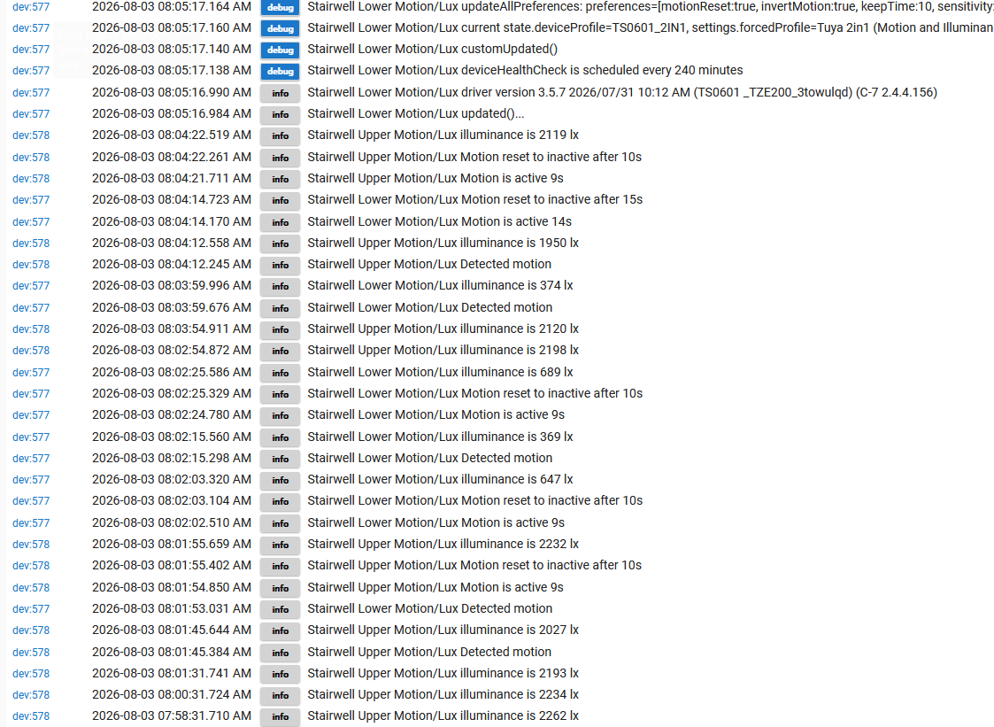

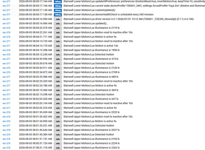

Afternoon sir @kkossev . I'm writing a long response in an effort to provide useful feedback for YOUR efforts. First - I have to say NO one writes drivers that are so sophisticated and robust and stable as you!
I have implemented the dev branch 3.6.0 from your URL posted.
I have a number of devices that are handled by your driver - I haven't any reason to look at anything besides this specific profile. I have 4 devices of this exact model, and they all use the same firmware as previously noted. (I updated them in HA easily a few months ago).
I know you stated I didn't need to re-pair, but I actually wanted to and did. I swapped the original devices with Virtual Omni Sensors to act as placeholders so I kept the 'in use by'.
I then Excluded all 4 units. Once they were removed, I took all 4 units and pulled out their batteries. (They go into searching mode automagically and will immediately jump back on if you don't.) One at a time, I started the Add Device routine - then put the battery back. It won't go into beacon until you push and hold the button for 10 seconds - then the light begins blinking and immediately they pop onto the Add Device detection window.
The device Instantly was recognized as I mentioned as a Tuya 2 in 1 Zigbee Mini PIR Motion Detecto + Bright Lux ZG-204ZL.
the unit automatically detected the profile perfectly as well. Tuya 2 in 1.
At this point I adjusted the Lux Threshold to 20 AND enabled the Advanced Options and hit Save. I learned that there is a unique characteristic that was problematic. The default value of the device and profile is 'Invert Motion Active/Not Active' is enabled! So, with the unit facing away from me, and no motion - it said 'Active'. I learned I had to turn that off. I also set the Min reporting time for the Illumenance to 30 sec. More that sufficient for my needs.
I did all 4 units this way, and it was flawless.
The device Attributes/and states are extremely detailed and useful.
The results so far are impeccable. I do want to have a 24 hr period where I can visually review the specific results of each device, but in the last 30 minutes, not one issue has shown in the logs!
This is the most amazing Driver - there is NOTHING as incredible as this - I love your library implementation as well! I remember when Tuya was... shall we say, problematic? The Tuya devices running under your driver head are the most stable and robust I have. Thank you. Feel free to PM me a link for coffee! - Shu
Reporting back in on the illuminance fix for 2 in i. It's perfect :slight_smile:
