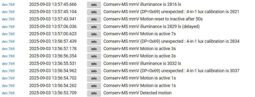

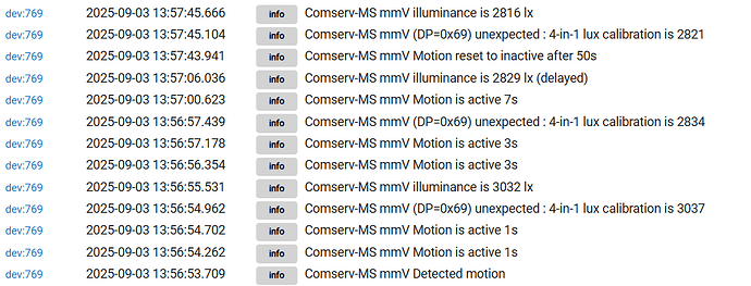

I have been using device for some time now. I realized that it is reporting a very low value for illumination.
I have 2 other types of device which reports illumination and this one is reporting like 1/10 of the others.
So I tried to dig in to the code to see if there is a divider or any other manipulation/normalization. I could not find any.
I added a log line just after the "isAttribute" check in "processTuyaDPfromDeviceProfile" function.
logDebug "${value}"
The value here is the same as the one reported on UI and logs.
So can we say that this is the lack of capability of the device ? Or anything could be done in the code ? (maybe I'm missing some scale/manipulation)
The problem is that the device can not report really low illuminance. It shows 0 for non zero light conditions. That makes the illumination function unusable in some cases.

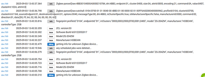

Hi @kkossev .
I've purchased a mmWave Motion Sensor.

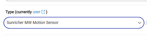

It was initially found but allocated 'Device' as the driver.
It's doesn't work correctly with your Tuya Zigbee mmWave driver but does with this one.
It does work OK with one small 'info' report in the logs.
I thought I'd post what I am seeing here in case you want to include it into this driver.
Here is the relevant information.
Here is the 'Get Info' logs.
Hi Bob,
This driver is for PIR sensors only, so it will not work with your mmWave devices. The logs that you see are due to random matching the standard ZCL cluster/attributes or Tuya ''Data Points' of other devices.
I will reply further on the mmWave sensor thread later on.

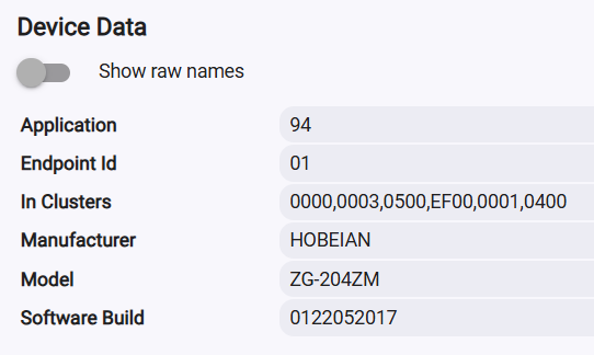

Just reading a bit more about this device, it looks like once motion is detected using an internal PIR sensor, it then activates the mmWave function.
Here is a paragraph from the spec.
The sensor is powered by battery and uses the PIR functions. Once motion is detected, the mm wave radar is activated.
Is it advertised to also measure temperature and humidity, as well as illuminance? I'm uncertain about how to classify it....it look more like a 4-in-1 sensor? The only difference seems to be that it contains both PIR and mmWave sensors.

Seems there are two different HOBEIAN models - one is working with the mmWave driver, but your model - not ? See here : [FINAL RELEASE] Tuya Zigbee mmWave Sensors (code moved from the Tuya 4 In 1 driver) - #315 by mgk65
Here ? [New device support]: ZG-204ZM similar to ZG-204ZL · Issue #21919 · Koenkk/zigbee2mqtt · GitHub

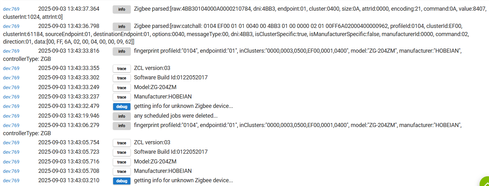

Hi,
i Bought ZG-204ZL but unfortunetyl doesn't work.
some one have and works?
my logs
