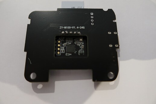

Spammy device 24G
Pair easily with HE using this driver
Reports distance every second. Oddly it will pause reporting for a few seconds every once in a while.
Will report inactive for a few milliseconds than back to active again while I'm present.
Will do this every 10 seconds or so then there will be a long period where just distance events are reported.
@bbholthome please update to the dev.branch version 1.5.2
There are some small changes in it, trying to achieve the MVP - presence detection (motion) working and reducing the spamming messages. Let's see if this true 24Ghz radar will work OK with the default settings.
The logs are much cleaner.
I sat still on purpose to get the inactive event. I see no evidence of the flicker between active and inactive for a few milliseconds. Great work but are you not concerned about all the distance reports putting a heavy load on the hub? So far I see no evidence of it.
