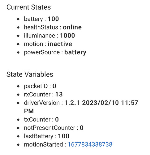

Would it be possible to change the format of the date/timestamp of “motionStarted” to a human readable format?
EDIT; Works with HomeKit integration app as motion and/or illumination device

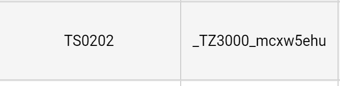

Hi @kkossev I have 4 motion sensors migrated to a C8 with your Tuya Zigbee 4 in 1 driver.
All are working fine.
I'm trying to pair another one with the same model, the correct driver is installed but no motion events occur no matter how many times it it repaired. Nothing shows up in the logs after the pairing. PS this motion sensor worked perfectly fine on a different C7 and readily pairs with it again.
