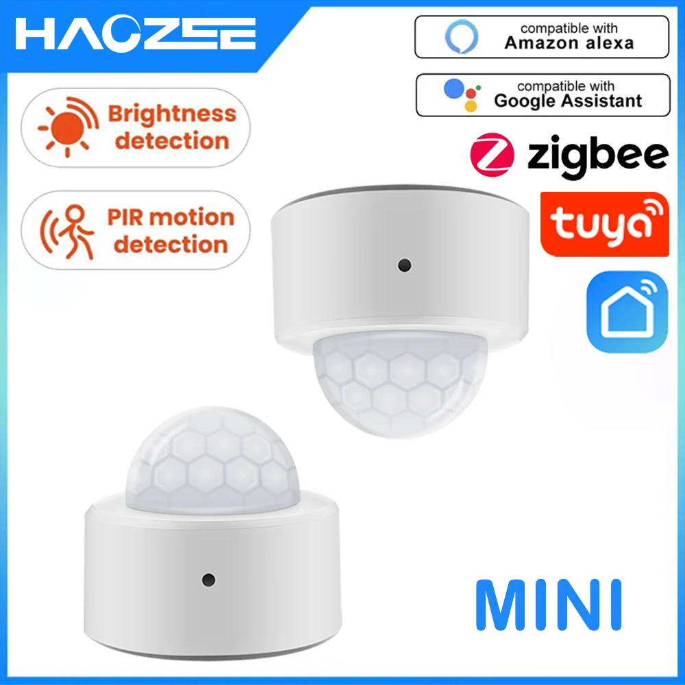

Also found these from the same seller on Aliexpress, similar to TS0202 but with light sensor.
Ordered 1 for testing, I'll let you know if it works.
It will be interesting to know for the 2 in 1 model whether the illuminance is reported when the light changes, no matter whether there is a motion or not. The 4 in 1 sensor works this way (independent illuminance reporting).
However, some cheaper motion sensors use to send illuminance reports only at the time when there is a motion detected, which makes the useability a bit questionable, except there is a 100% guarantee that the illuminance is reported (and processed in HE) well ahead of the motion event.
I'll update here as soon as I test it. Might be a nice(cheap) alternative to the 4in1.
