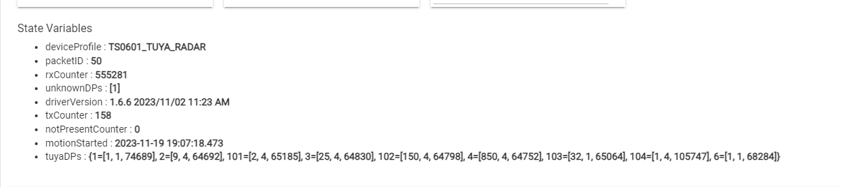

@AdrianCanuck please identify your device model and manufacturer ( the ''Device Details' data section at the bottom of the web page). I just counted 57 (fifty-seven) different mmWave sensors devices, each of these may behave differently.
Hello, thank you for your response. I tried to pair it several times near the hub. Even I let it sit near the hub after pair several hours. When I pair it it shows battery status and motion active but never switch to inactive. When I switch it to inactive manually (with motion button) it will never go active with motion again. I have Hub C-8
Can you post the model/manufacturer data ?
I mean this :
Device Details
Also, please post of the State Variables section
State Variables
Snímek obrazovky 2023-11-19 202143
Snímek obrazovky 2023-11-19 202222
TS0202 _TZ3040_bb6xaihh requires the following options to be enabled in the Preferences section :
This device does not send itself 'motion inactive' event, that's why the software timer must be used.
If it still doesn't work, please update to the latest dev, branch version (the link is in the second post), currently it is ver. "1.6.8" "2023/11/13 11:50 PM"
