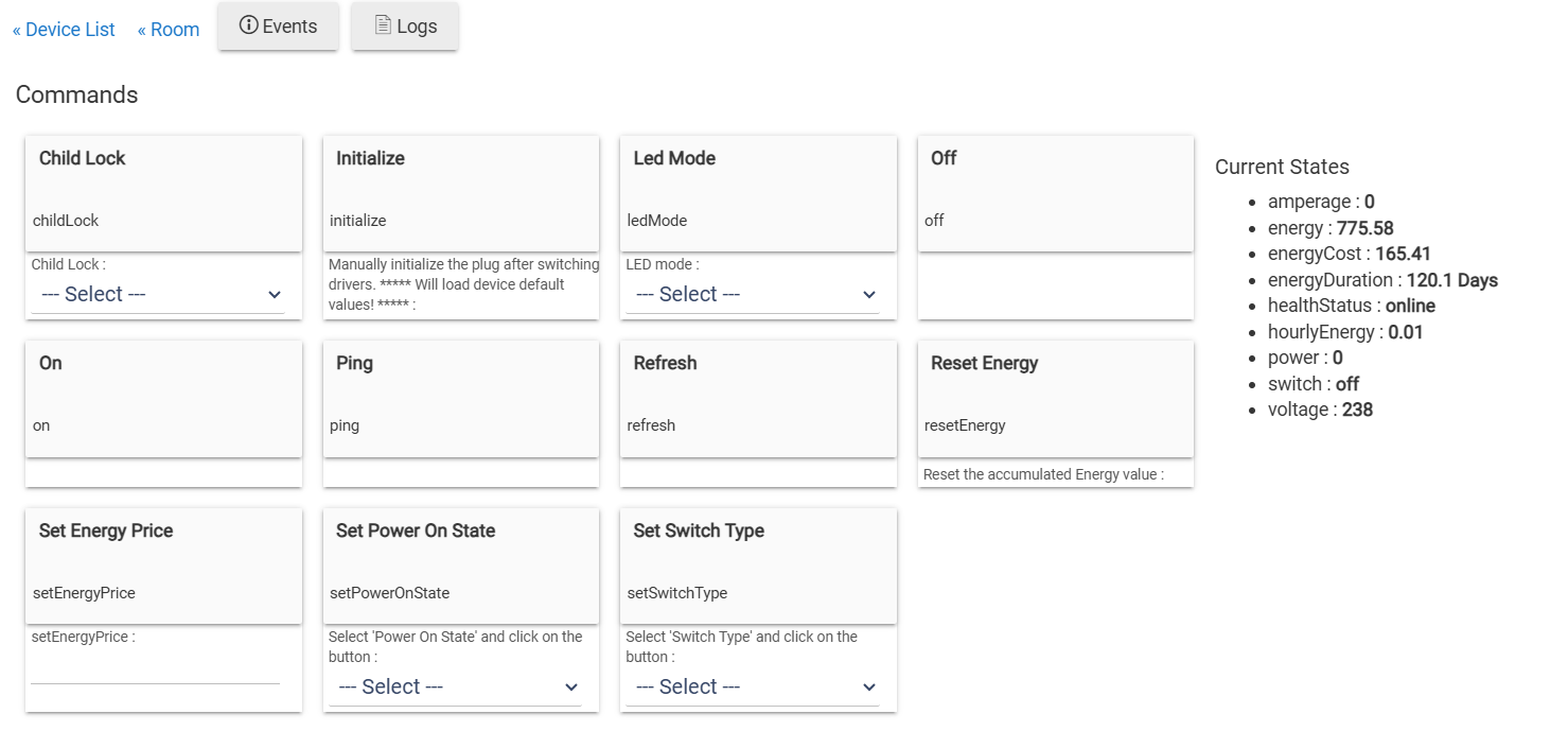

there is a "set power on state" setting on your device handler.
I am not sure what it was before (doesn't show), but now I set it to "last state"
maybe that could save me ?

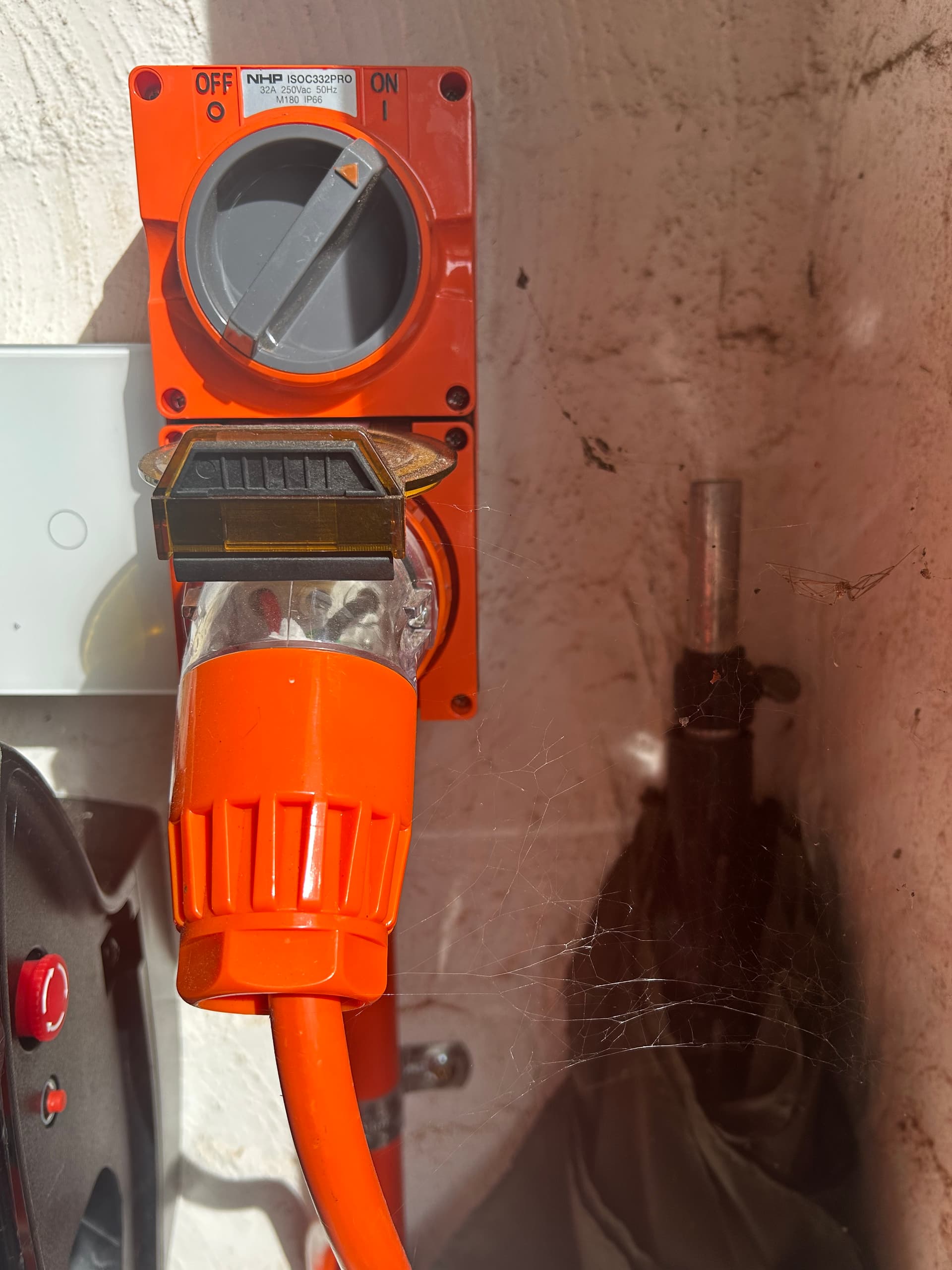

Normally I use a 20A plug and normally my usage was not exceeding 17A
Today I saw it goes up to 19.5A
would this be causing the issue ?
Does the plug stop when it goes over 20A ?
That's a very likely reason!

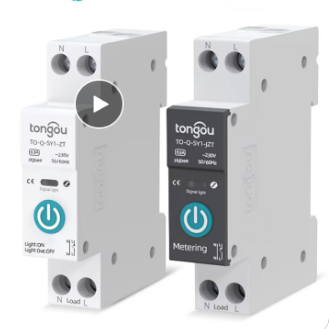

I wouldn't trust this plug handling safely 20A... Have you looked at the DIN rail circuit breakers available on AliExpress? Search AE for 'Tuya Zigbee DIN' ...
There are models rated 50A++ , they have configurable under/over voltage and current protection configuration.

There are DIN rail high-power switches listed on the first post in this thread .
so the suggestion is I remove the zigbee plug and instead of it I use a zigbee DIN which would support up to 40 or 50A
I will be able to turn on/off using the same driver ?

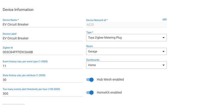

I received and installed my new circuit breaker today. The driver works fine.
But it is a 63A adjustable device. How can I adjust it to 32A max ?
