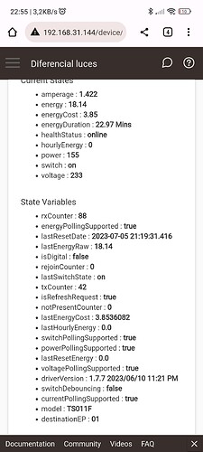

I put the updated driver, I think that now it's fine, right?
Yes, all states seem to be OK.
Always try the latest development branch version (the link in the second post) for new devices.
This one was added just recently.

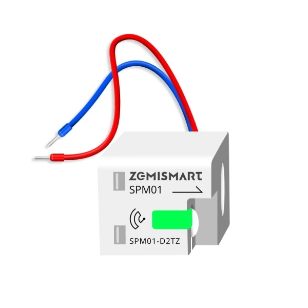

Hi @kkossev,
I'm trying to use the power meter below with this driver. It pairs but it's not working. Take a look when you have time, please.
Thank you for always helping us.
@joaomf please update to version 1.8.0 "2023/09/03 11:09 PM" from the dev.branch
I have added this device to a group that partially matches it.. Not sure what will work and what not, please test and let me know the results.

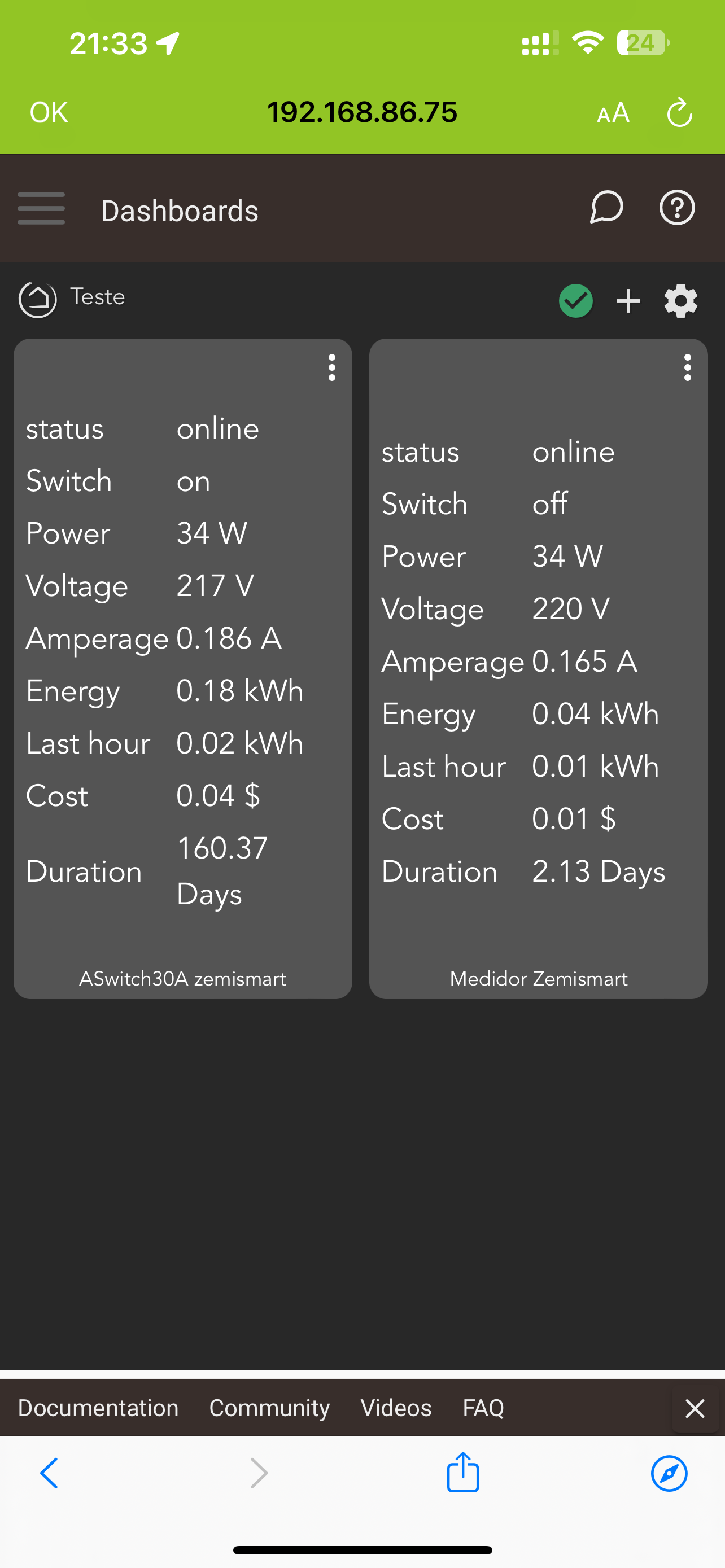

@kkossev, it’s working !!
The first tile (left) is a Switch 30A and the second is the Zemismart Meter.
I'm going to test with other appliances and let you know.
Thank you very much !!

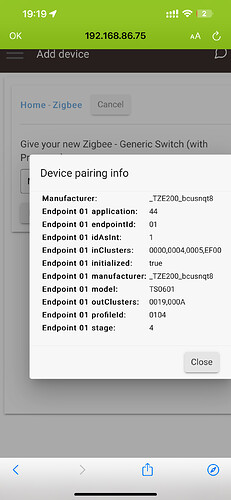

Can you post the fingerprint of the 30 A switch?

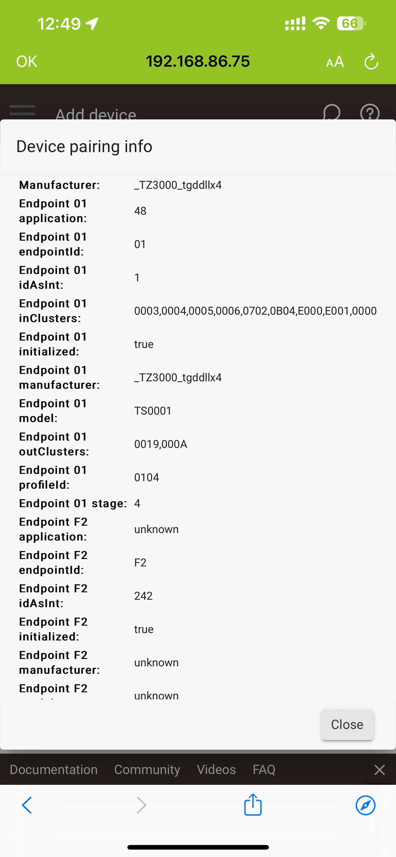

Post the device pairing info like in the post above.
Thanks, here is the information. Also, I am pairing it to a C7, which I understand does not have Zigbee 3.0, but perhaps would be able to communicate via 1.2 to the Mini Plug 2?
