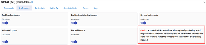

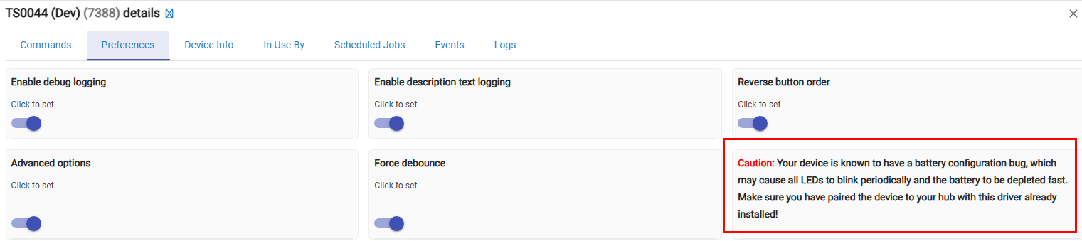

  • added a warning text for some models that require obligatory re-pairing :

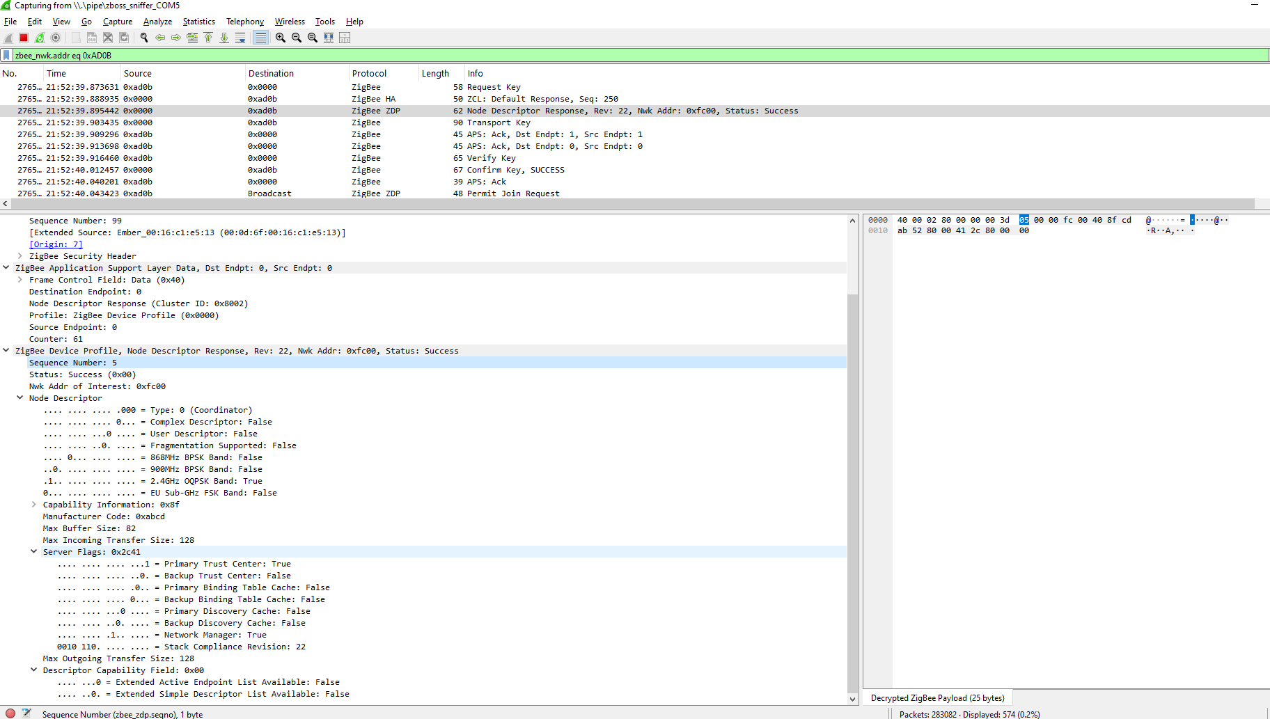

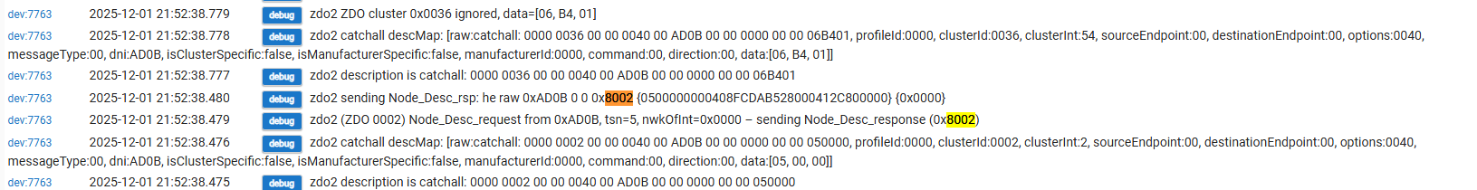

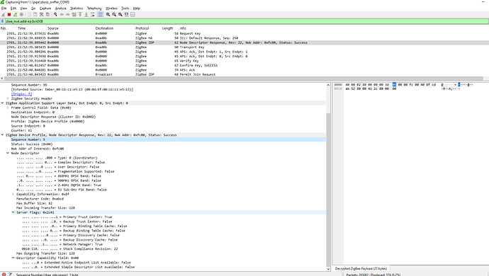

I successfully reproduced the flooding of ZDO Node Descriptor Requests caused by certain devices after an 'incomplete' Zigbee pairing process.... And now this custom driver successfully simulates the ZDO 0x8002 response that the Hubitat platform is expected to send as a system-level answer :
Tuya Scene Switch TS004F ver. 2.9.0 2025-12-01 :
  • handleNodeDescRequest()
:partying_face:
