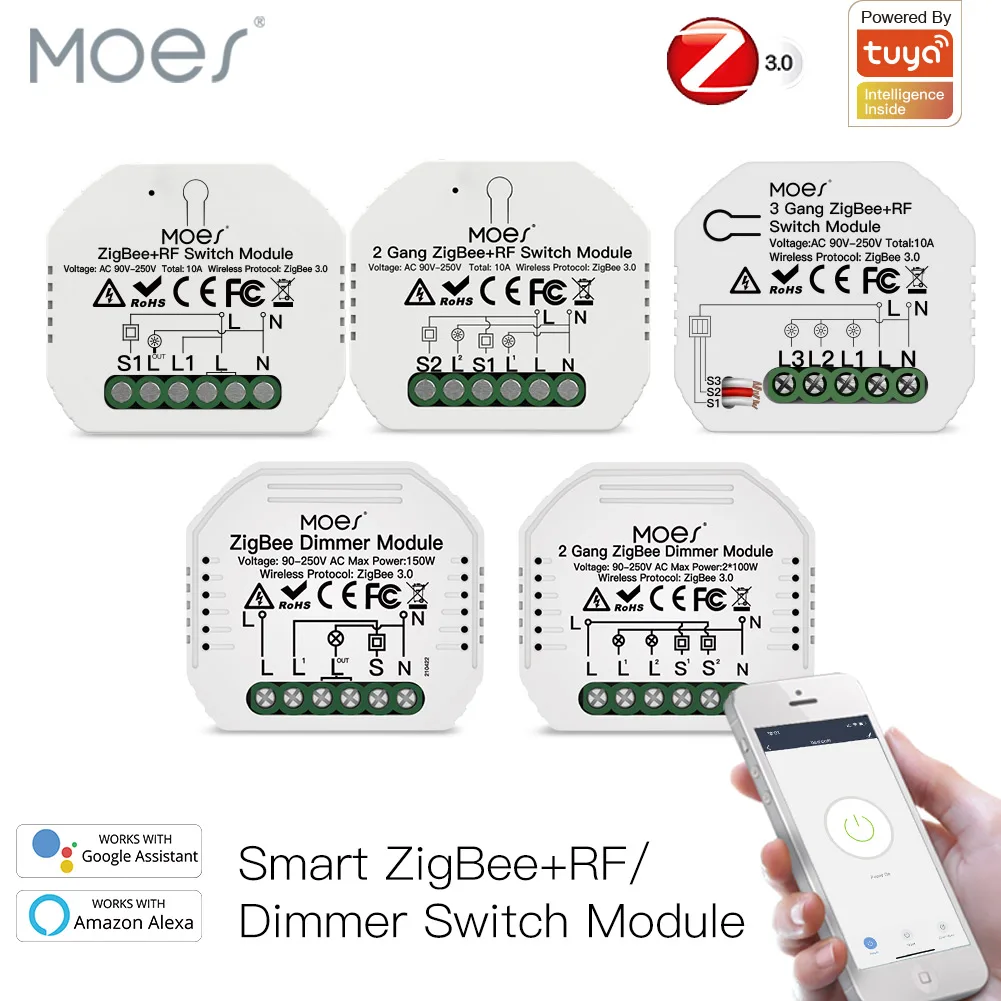

I have got myself a 2 Gang Zigbee Dimmer module by Moes. I think they are by Tuya. I have installed the driver and initially wired to one lighting. it was working perfectly (thank you) Tired to wire to the second light but I just could create a child device. Any suggestion please?

sorry it has been busy few weeks.
yes you are correct in that I couldn't create two child devices. this the module that I have got
the fingerprint of my device is as of below
- endpointId: 01
- application: 42
- softwareBuild:
- inClusters: 0000,0004,0005,EF00
- outClusters: 0019,000A
- model: TS0601
- isMultiEP: false
- manufacturer: _TZE200_e3oitdyu
No problem @ugm2byww and thanks for the fingerprint.
I must admit it is a little confusing - looking at what cluster IDs it supports it implies it doesn't support the standard commands for on/off and dimmer level adjustment. Did you say the driver did appear to work for one of the channels? Both for turning on/off and for dimming? If you can confirm that it does then I'll roll an experimental version for you to try.

Hi @Silvermane I'm afraid the fingerprint for the Moes device indicated that it uses proprietary ZigBee commands. My driver therefore won't support it.
It would need someone who owns one to do some detective work sniffing and deducing the proprietary messages to write a driver for it.
