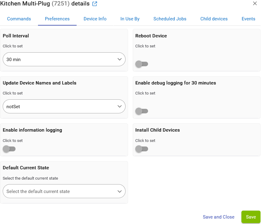

I recently purchased a Tapo Smart Outlet Matter version P210M, using Tapo Integration the Tapo plug is added into Hubitat but there is no plug 1 & plug 2 option to control the outlets, I assume I missing drivers but can't find any.
Go to preferences, select "Install Child Devices" and save.

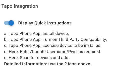

I'm having trouble getting my first Tapo device to be discovered. It's the P100 non-Matter plug. It's alive, exercised through the app, but cannot be discovered. I can ping the IP on our network and it responds. I've ensured that the scan range includes the IP and that it's on the same subnet as the hubitat.
any hope of ever getting cloud support back? .. i still have devices that are on a secondary network for backup and therefore not reacheable on the hubitat network.. would be nice if i could get myrules to control them working again.
In the Tapo app, you need to enable Third Party Compatibility. See the quick start instructions at the top of the app.
It may take a while for the device to update. Also, some debug logs would be helpful if this does not work. This will actually allow me to do something.

Thanks. I certainly read the Quick Instructions, though I skipped the task about enabling third-party integration on my account since I already did it days prior. But just to be sure, I disabled it and re-enabled it since I already had the P100 plug added to my Tapo account. That being said, I'm still unable to add the device to the app.
Note: I am 1000% sure my Tapo credentials are correct.

@djgutheinz - This seems to be the same issue I'm experiencing.
