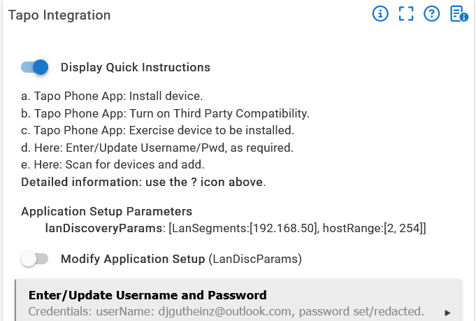

Yes. New protocol that will require someone figuring it out. It is pretty draconian.
Check the app and verify that the IP segment on the first page is what your devices actually are.
Make sure your credentials are correct.
Have you made router changes lately. That can cause permission problems.

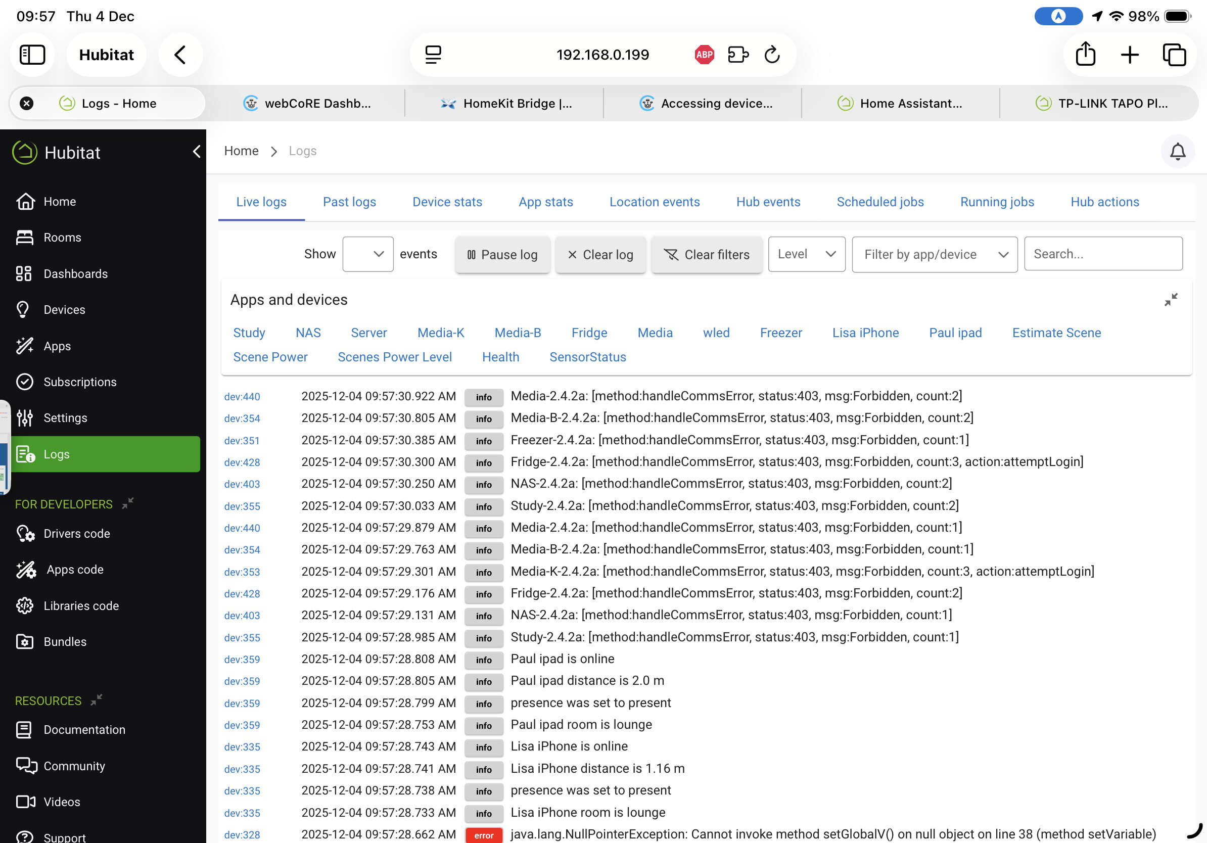

Logs: still saying things like "Hearth Lights-2.4.2a: [method:handleCommsError, status:403, msg:Forbidden, count:3, action:attemptLogin]", but the hearth lights can be turned on and off using Hubitat.

I updated my smart plugs yesterday, and they dropped off HE. I disabled then re-enabled third party support, rescanned and everything seems to be working. However, this morning I noticed all these errors in the log, running non stop
Forbidden implies a credential or protocol issue.
Updated. I put out a message recently saying not to update right now:
The forbidden message means you are locked out of the device for some reason.
Update firmware may have updated the protocol to the currently unsupported TPAP.
Password may have special characters (did you change your tapo password?). See below.

  • Check if the devices now work. If so, tell me. If NOT - send the APP from the last run only. The debug data will have information that is useful.
  • I also need the model, hw version and Firmware Version of your devices.
