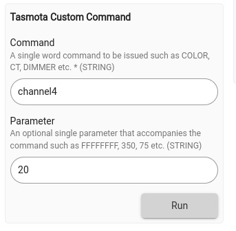

I am trying to use 'tasmotaCustomCommand' from 'Set Variable, Mode or File, Run Custom Action' in the Rule Machine (rule-5.1), but nothing happens...
This works from device:
As does this:
This does NOT work (from Rule Machine):
(I don't even see any activity on the console at all!)
Try putting both parameters in quotes and then both not in quotes if the latter does not work. Turn up the logging on the device and the check the Hubitat log to see what happens.

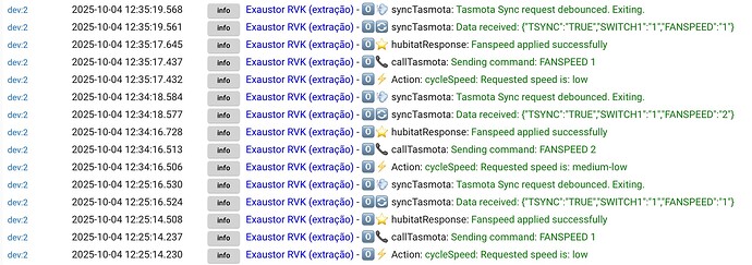

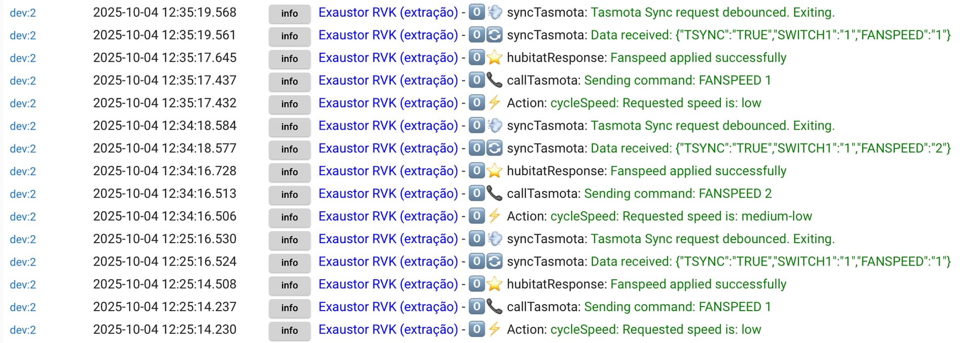

Hi @garyjmilne,
I'm using your solution and it has been working fine.
BTW, congrats for the solution to connect Tasmota devices (mine is a Sonoff IFan04) - sometimes the best solution (cost x benefit) is not the complicated or sophisticated one, but solutions like yours: elegant! Beauty is in the details! :ok_hand:t2:
I'd like to ask you what exactly the message "Tasmota Sync request debounced. Exiting." means. I can see that it's connect with the "Debounce Interval for Tasmota Sync" parameter (set at the 7000 ms default value). However, since I've been getting this message for each command (see log below), I don't know if something is wrong with my installation or not.
Notes:
  • Dev:2 is a device using the "Tasmota Sync - Fan" driver (Tasmota Sync Fan Driver with Switch version 1.0.2)
  • The Tasmota Sync Broadcaster version in use is 1.1.4
Thank you in advance!
That is normal. If you are curious why I think you'll find an explanation in the docs. It has to do with ignoring the immediate response from Tasmota and waiting for the rule to fire as the definitive indicator of success or failure.
I missed the docs totally ...
Yep, it is there!
Thanks!!!!

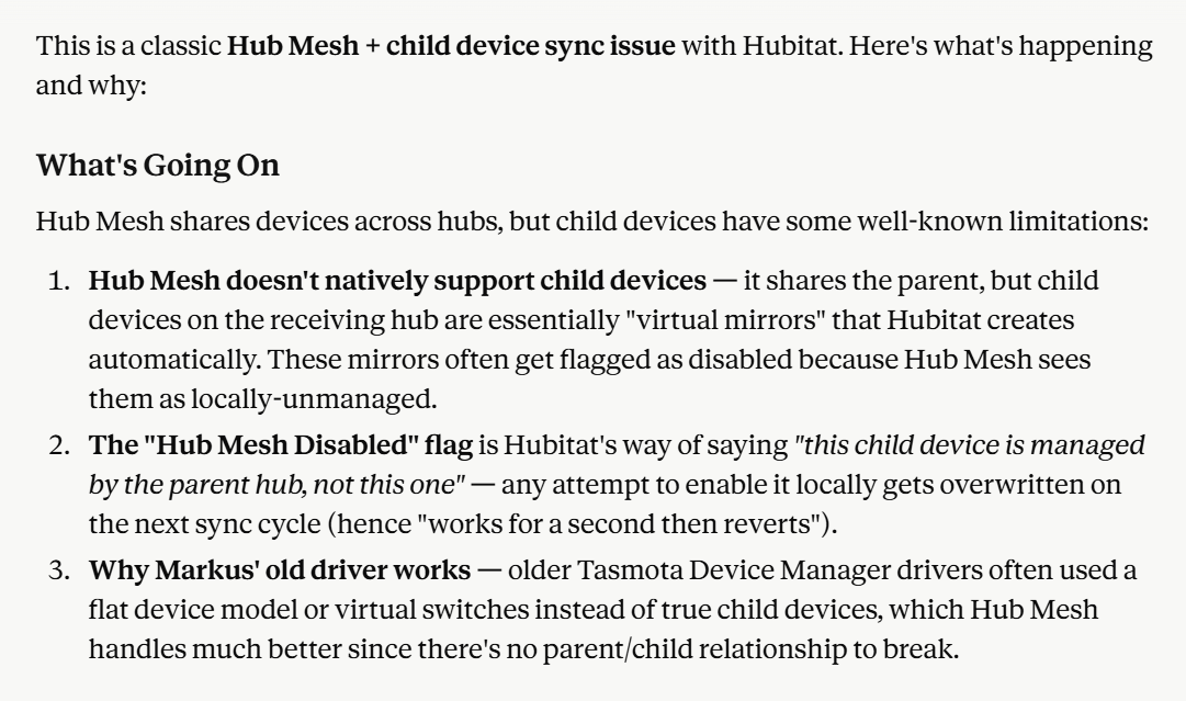

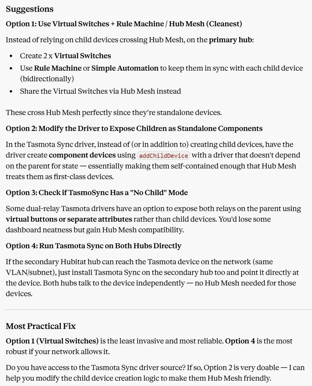

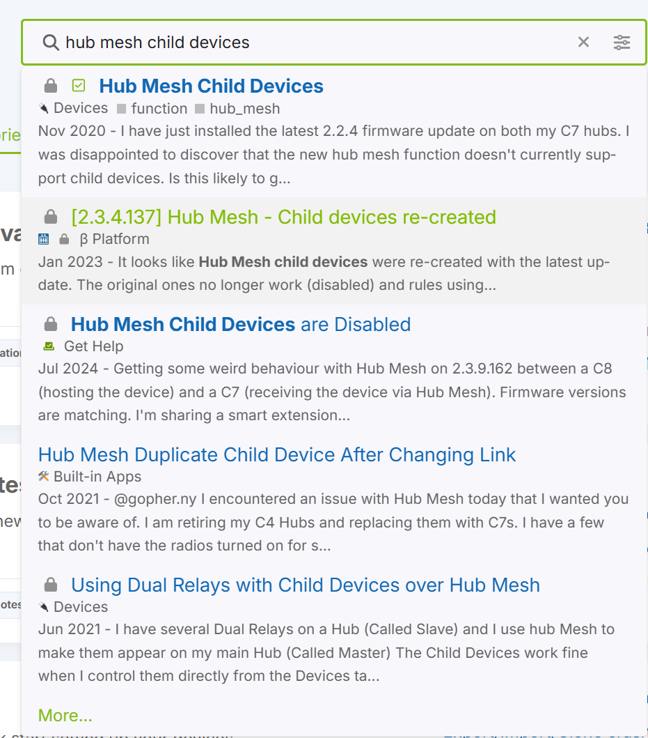

Any suggestions? Tasmota Sync works fine on the primary parent device (both switches work in the parent but only show up as a single device in the dashboard using Hub Mesh so need 2 child devices).
However, if it has child devices (dual GPO) the child devices (work fine on the primary hubitat) are disabled on Hub Sync hubitat. It says (Hub Mesh Disabled - true) on the Commands tab on the shared hubitat. It you enable this child it works for a second then goes back to disabled.
If I use Markus’ old Tasmota Device Manager the Child devices work on the shared hubitat but it is hard to get them to refresh their state.
Any tips?

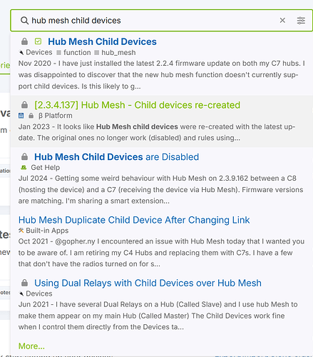

This is the answer I got from Claude. I’m not vouching for it or implying it is correct but it sounds plausible. Hub Mesh with Child Devices
This seems to be a fairly well discussed topic so it might be worth checking around.
