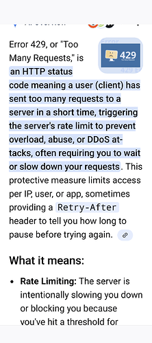

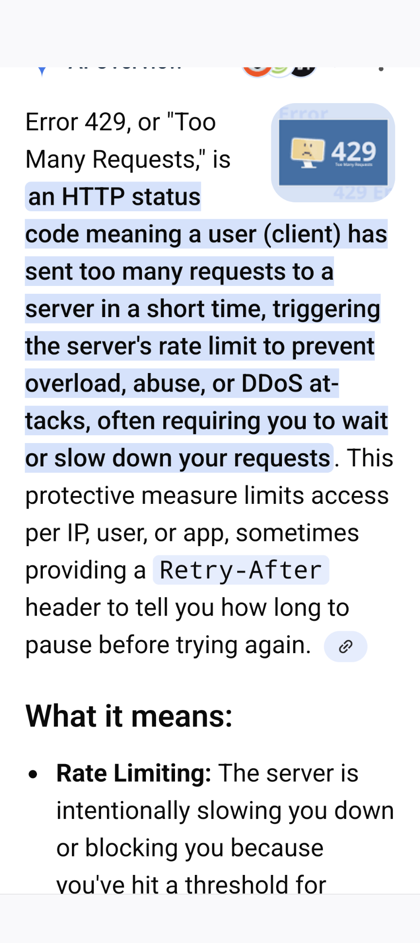

Today this integration stopped working.
I'm getting HttpResponseException: status code: 429 which on a google search says
" The HTTP 429 Too Many Requests client error response status code indicates the client has sent too many requests in a given amount of time"
I'm assuming this means Tado have invoked their restriction as indicated above.
Any one else getting this or has a work round to get it working?
Hi Bobbles,
Yes, sounds like they are limiting you.
