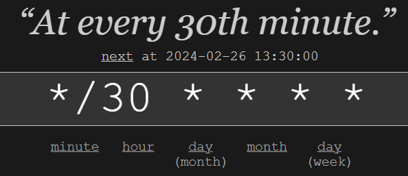

This is how I have changed mine to poll users every 15 seconds while the system state is every 30 seconds.
Not sure if this helps.
// Schedule it to run every 5 minutes
//	runEvery5Minutes("poll")
//    runEvery5Minutes("userPoll")
    schedule("5/30 * * * * ? *", "poll")
    schedule("5/15 * * * * ? *", "userPoll")
You could change my example to...

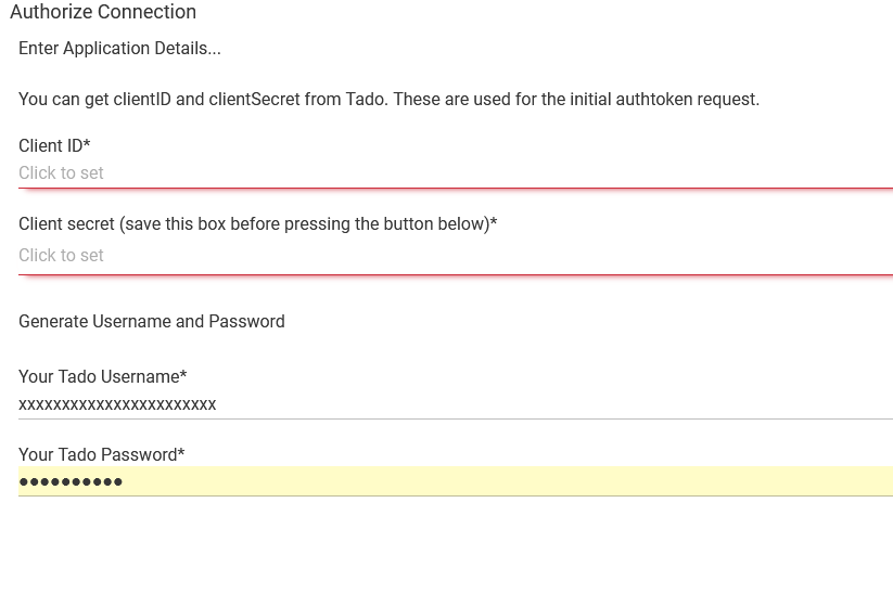

Thanks for the reply. I had missed that completely. Can you confirm where exactly I should put these? I'm not familiar with groovy so a bit unsure here. Thanks in advance
After you have inserted the app code and drivers. Go to "Apps" - add user app - Choose Tado Connect
In the next screen you can put the Client ID, Client Secret and your username and password.
Thanks. In the version from the @Bibbleq repo it doesn't prompt me for the Oauth details
I've installed the alternate version from @user3860 and now get the same as your screenshot.
