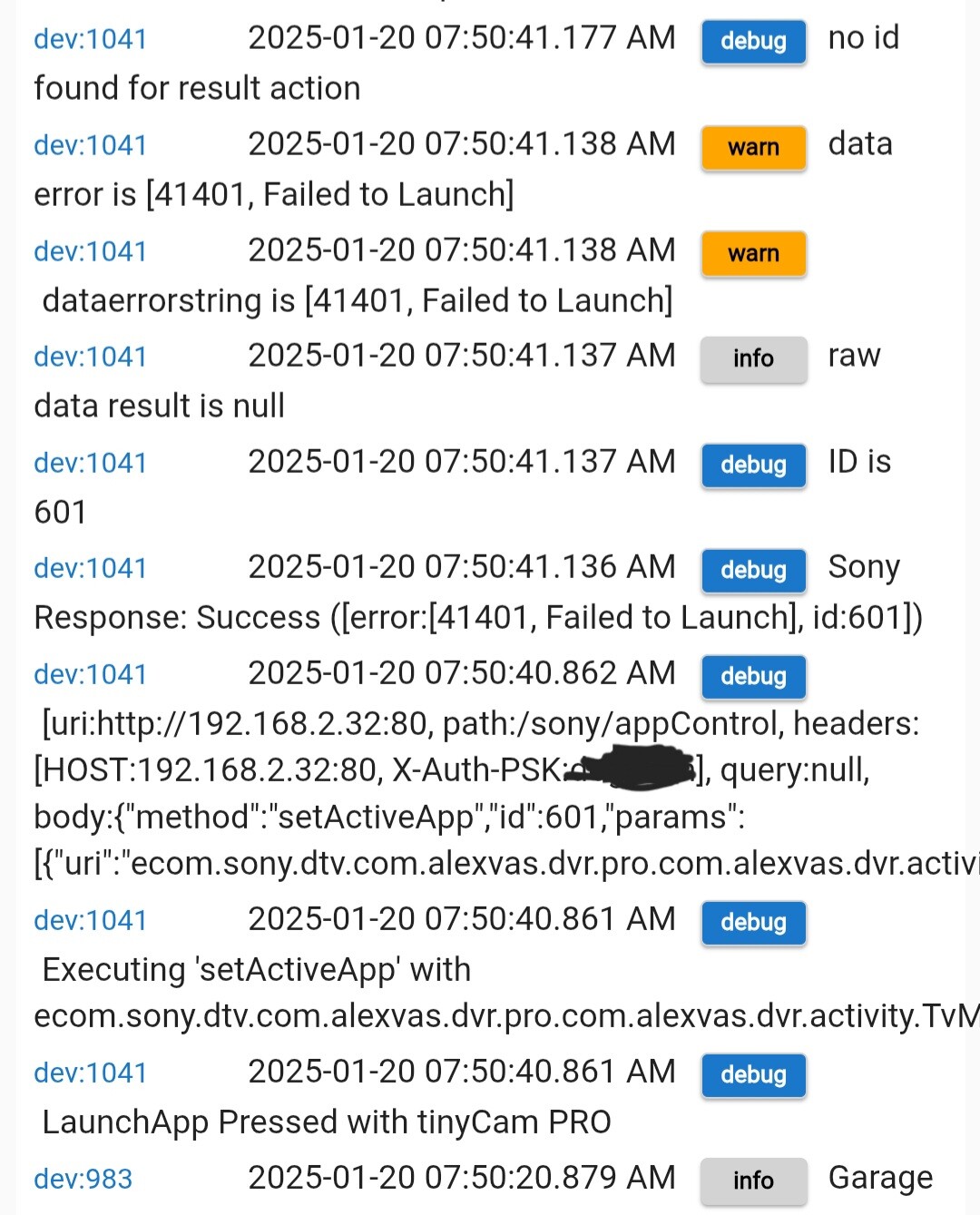

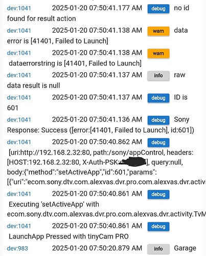

I set up my x90L with this driver, and everything works except the one command I needed: launch of the TinyCam PRO app.
Is there anything else that needs to be done in the TV settings to make it launch? All other apps included in this driver successfully launch, except tinycam.
No errors or any other data is given in the logs when trying to launch it from the drop down in the device page.
Any ideas?
Looks like I did not have dubug logging tuned on. Here is the log when I try to open tinycam pro from the HE device page. I added Tinycam pro to the TV, obviously. Is there something I need to do to tell the driver where it is located on the TV? It opens when I open it manually on the tv, just not using this driver.
