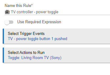

Hi Angus_M what was your final rule to get the Sony TV to toggle mute and unmute, every other time.
Yes, very simple...
Thanks, is this mute and unmute, or just power.
That was power, this is mute:

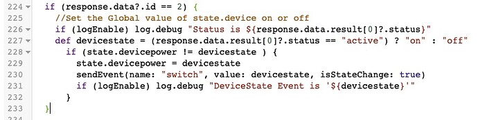

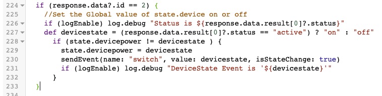

I believe I had a similar issue - I have a RM 5 rule to turn on an LED backlight (via a Sonoff Zigbee plug named Backlight) when my Sony TV, an XBR-55X930D, turns on and to turn off the backlight when the TV turns off:
It was intended to be triggered anytime the TV on/off state changed (I have the Refresh Interval set to 1 min), but I found that I was getting a changed rule trigger every time the TV on/off state was queried, even if no power state had changed. I edited the driver at line 224 to check the current state.devicepower against the query response before issuing an event, like so:
With this change I got the behavior I was looking for: backlight comes on when TV turns on, doesn't turn off until the TV does. Note that I have absolutely zero Groovy coding experience, so @ajones was this the appropriate way to handle the superfluous devicepower state triggers? It appears that event triggers based on querying other TV parameters follow the same model as the original on/off event code and may exhibit a similar issue.
Nice improvement, thank you!
