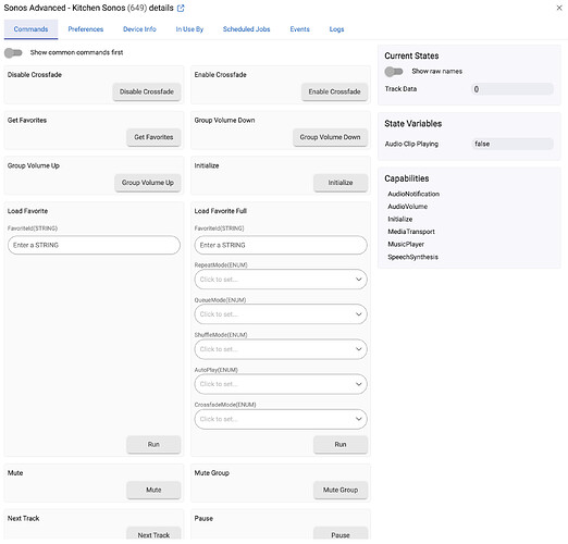

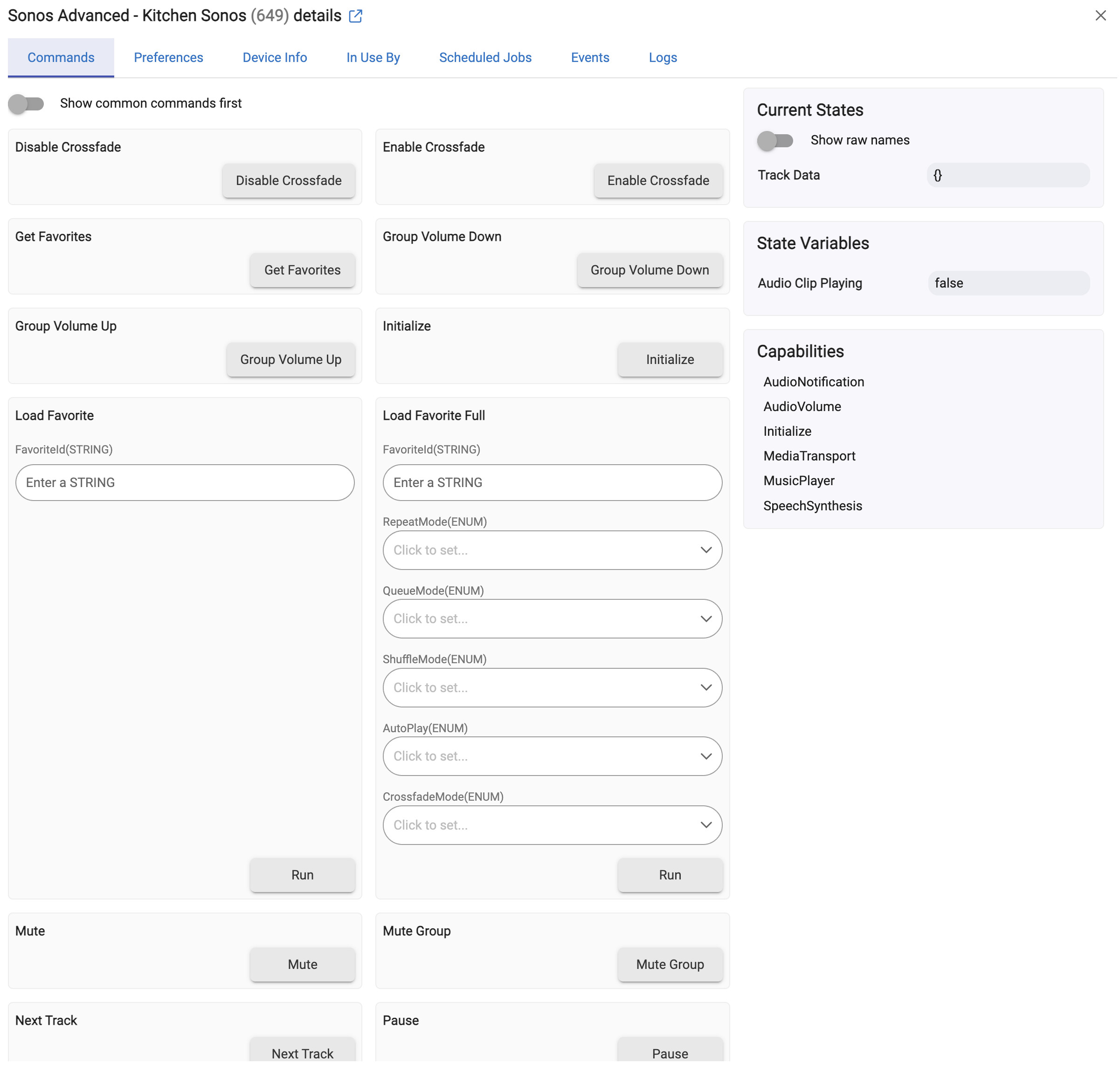

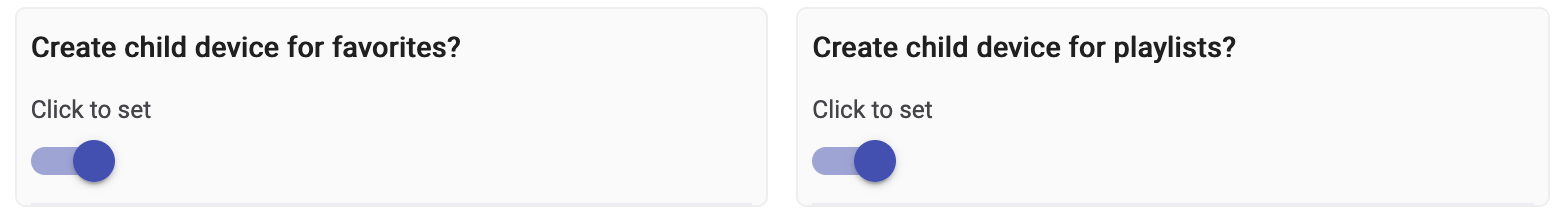

Hi all, is there a dummy guide to this? I am stuck at even getting the favourites loaded. "Get Favorites" button does not seem to create any new items I can see.
Enable a "favorites child device" (and playlist, if you want that too) on one of your Sonos. There's an update that runs nightly to update the favorites, and "getFavorites" updates it immediately. The child device created should show all your Sonos favorites and provide the favorite number that's needed to start a favorite from a rule. It works across the whole "household", so you only need to enable this on a single speaker.
The commands don't have any way in Hubitat to be conditional. It's all or nothing for command and capabilities on a driver, so I can't do anything like "only show get favorite if there's a favorite child device created". So there's the same commands on all speakers, regardless of whether or not they have a child favorite created. Hubitat limitation.

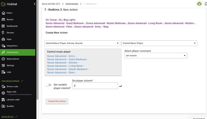

First of all, MANY THANKS for putting in the time for this functionality!

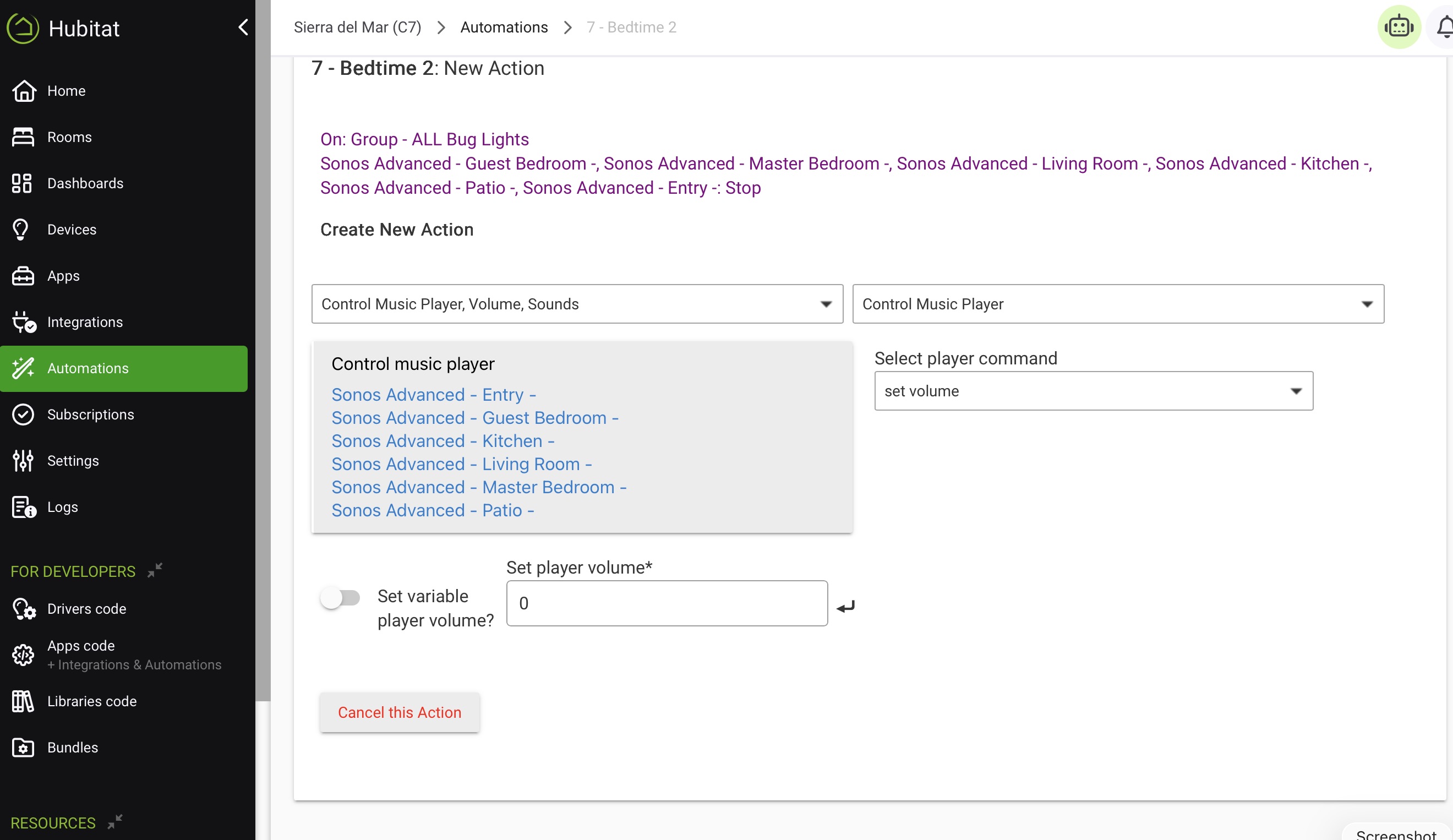

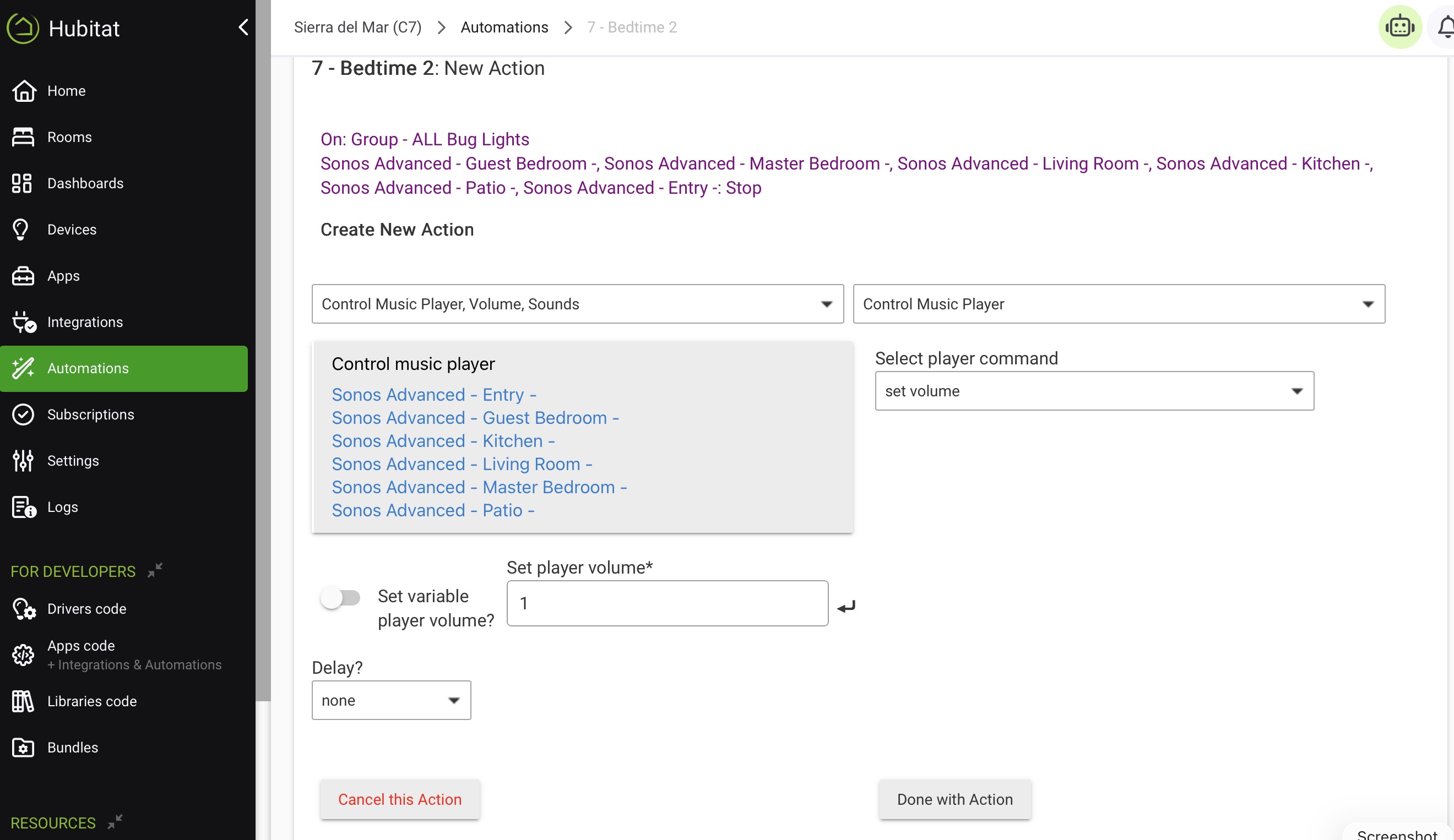

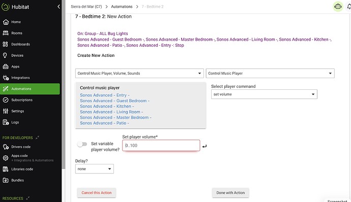

I'm using 0.11.7 and trying to set the volume to 0 on all of my Sonos speakers as part of night time daily housekeeping.
While the "system" shows that a volume for a Sonos Advanced controlled speaker can be set to a range of: "0..100" (i.e., no volume), the 'system" only allows for it to be set to a minimum level of '1'.
I'm not sure if this is a bug in your app or the general Hubitat "system"....
Thanks!
Peter
Just to update, I did a complete uninstall and reinstall of the driver to get it working. Should have tried the usual "solution" earlier.
Just a thought, but why not just use mute?

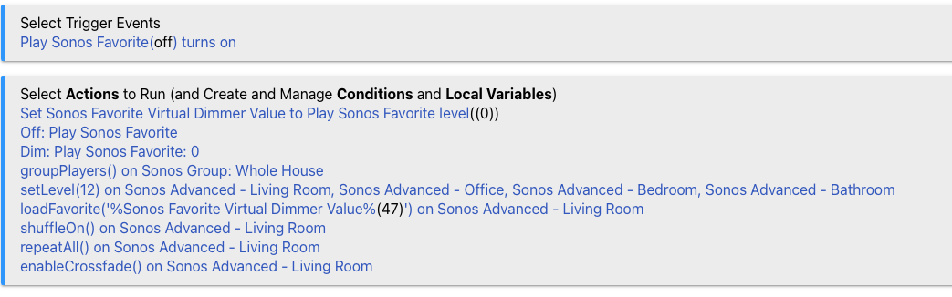

I have a simple routine I've setup that plays a Sonos favorite on all my speakers (all rooms). Over the years, it has generally worked, but I would give it about an 80% reliability rating. Sometimes I have to run the routine multiple times for it to actually start playing the favorite. When it fails, typically just nothing happens. On occasion, it will start playing the favorite but only on a subset of rooms. I haven't been able to narrow down the issue(s). I've even tried inserting delays between commands thinking perhaps the Sonos API just couldn't keep up (not sure if that's even a valid theory). When I look at my Sonos Controller app after running the routine (and it fails) I sometimes see that the rooms have all been grouped and the proper favorite is selected, but it just didn't start playing. In other cases, I see either nothing selected (i.e. no favorite) or I see that the rooms haven't been grouped. The results seem to be random.
I was hoping to have someone take a quick look at my routine (below) and tell me if I'm doing anything wrong/superfluous to achieve the desired result. For context, I use a virtual dimmer and, through an Alexa voice command, I set that virtual dimmer to a value equal to the Sonos favorite number. Turning on that virtual dimmer is the trigger for this automation. I've checked many times, and that part of the routine always executes perfectly - the virtual dimmer is always set to the correct favorite number. It's the Sonos actions...grouping/select favorite/play...that seems to be the problem.
Thanks in advance for any advice/error corrections...here it is...
I created a Virtual switch(VS) for mine to run and what I found was the VS turns on to run the action, then stays on. So I set it up to automatically turn it off after turning it on.

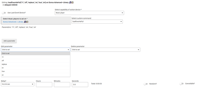

Here’s an example. This was before the author added support for grouped speaker control.
It’s done using a speaker custom command, like so:
One thing that seemed to help me is to ungroup all the speakers before playing and joining:
But, I did see above that the author now has added the ability to fully control groups. So, I might try setting up the group with Sonos Advanced, and then just issuing the command to the group.
