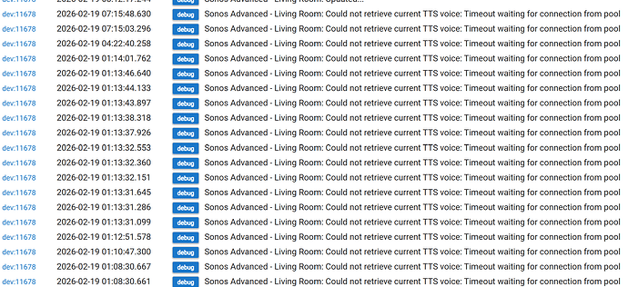

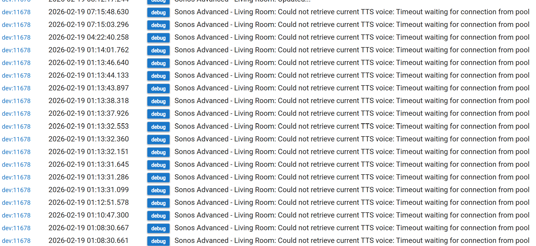

These are the debug logs that came in through the night.
I also had numerous 'hub load high' messages come through from a WC piston I configured to report high load.

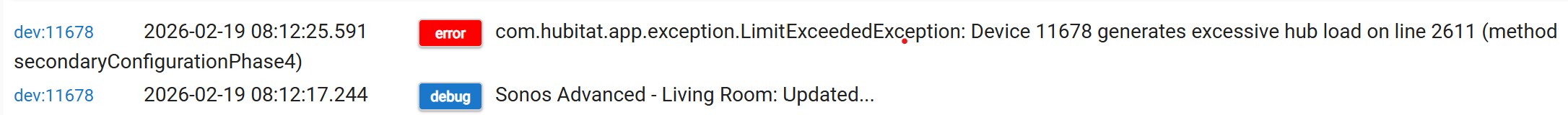

I updated this morning and received this error.

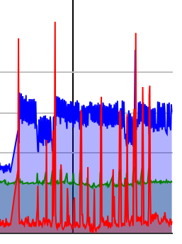

Just for info, this shows the load on the hub in red.
The blue line is free memory and shows when I rebooted yesterday when the hub load increased after updating the Sonos app.
When the red line flattens out again is when I disabled the App.
The secondaryConfigurationPhase4 callback is part of a chain that runs when the player device is first created, or when clicking on "initialize()" or "configure()". Initialize runs at bootup, too. Is there something causing this to be invoked around 8:12? Are you possibly calling one of those functions in an automation/rule/piston?
Looking into the other issues listed here recently. Just wondering why this seems to be getting called on your hub. It doesn't seem like it should be called that often. It should still not be taking "too long" to complete and causing an error, but I'm also just wondering if it's somehow being called more often than I would expect it to (which is only at boot up or when initially creating a device).

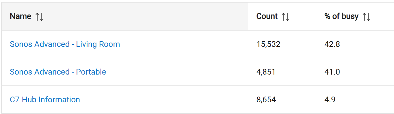

In device stats my 2 Sonos devices are top of the list for busy percentage.
If there's no errors and things are working OK, if you have logging on you can try disabling the logging on the device. The logs are very "heavy" in terms of CPU usage, so mostly you want to have them turned off. I'd only have them on for troubleshooting... turn them on, repeat the steps that resulted in an error, capture all the logs, then turn back off. Keeping them on 24/7 can definitely slow things down.
If they're already off, then run things for a bit with them on, with trace level, and PM me with some sample logs.
