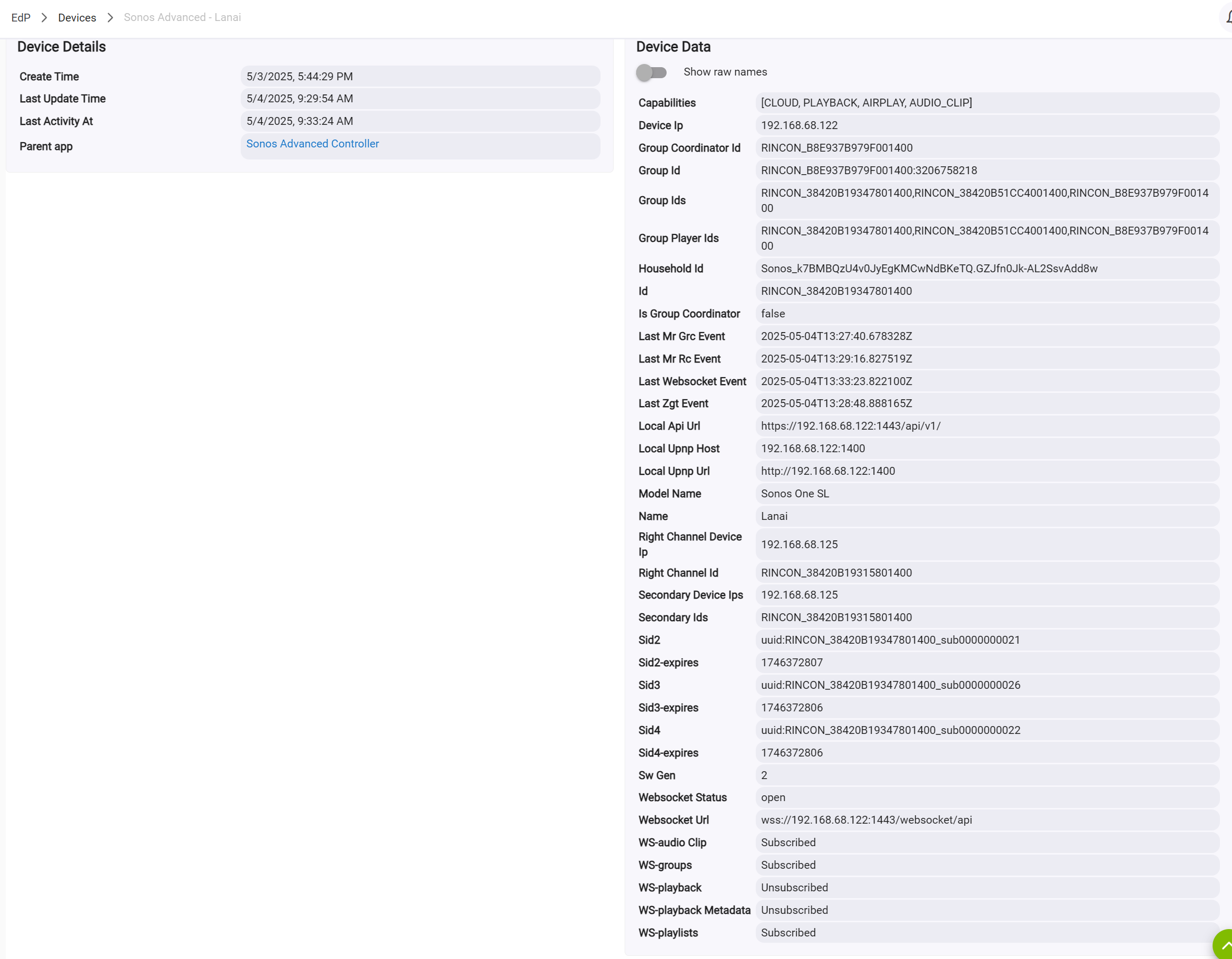

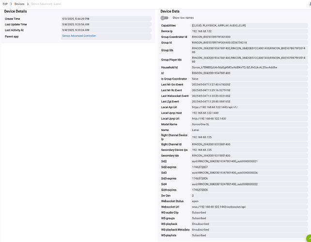

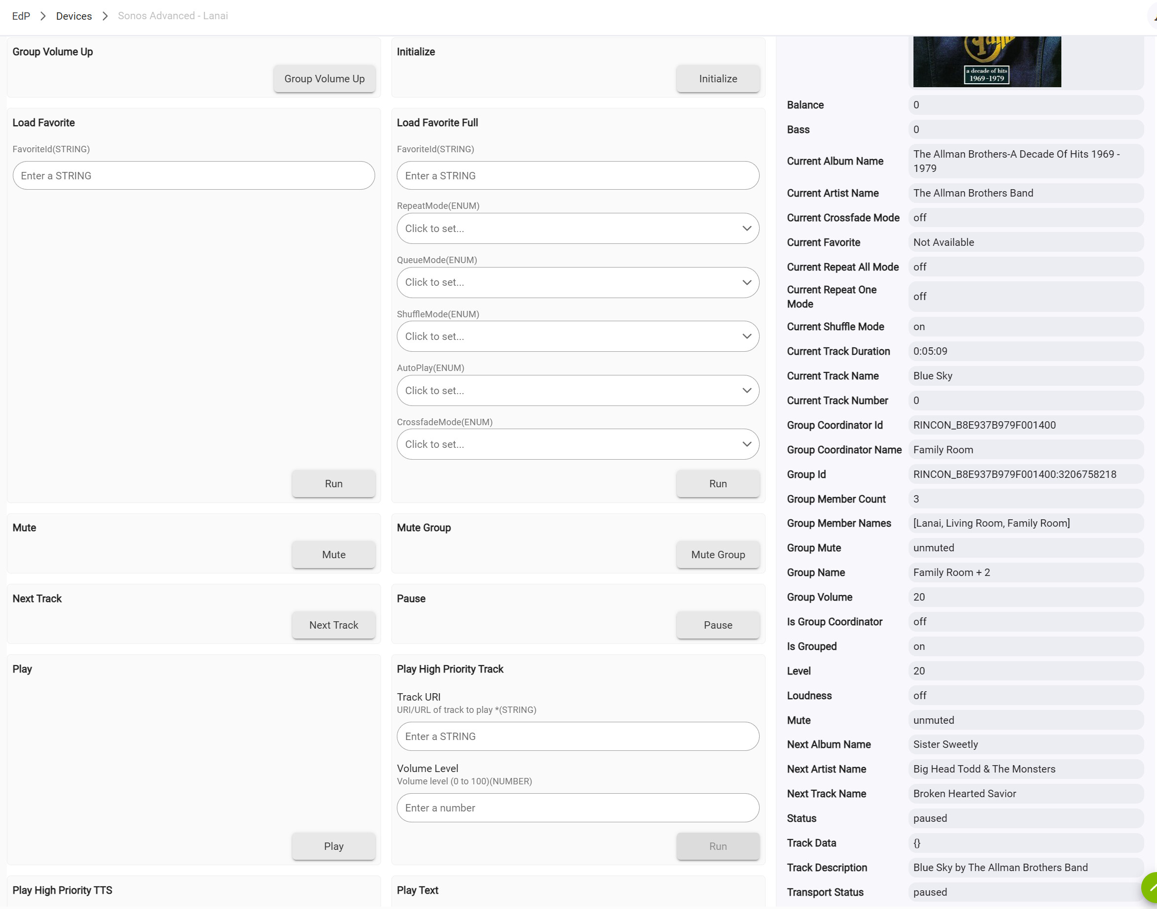

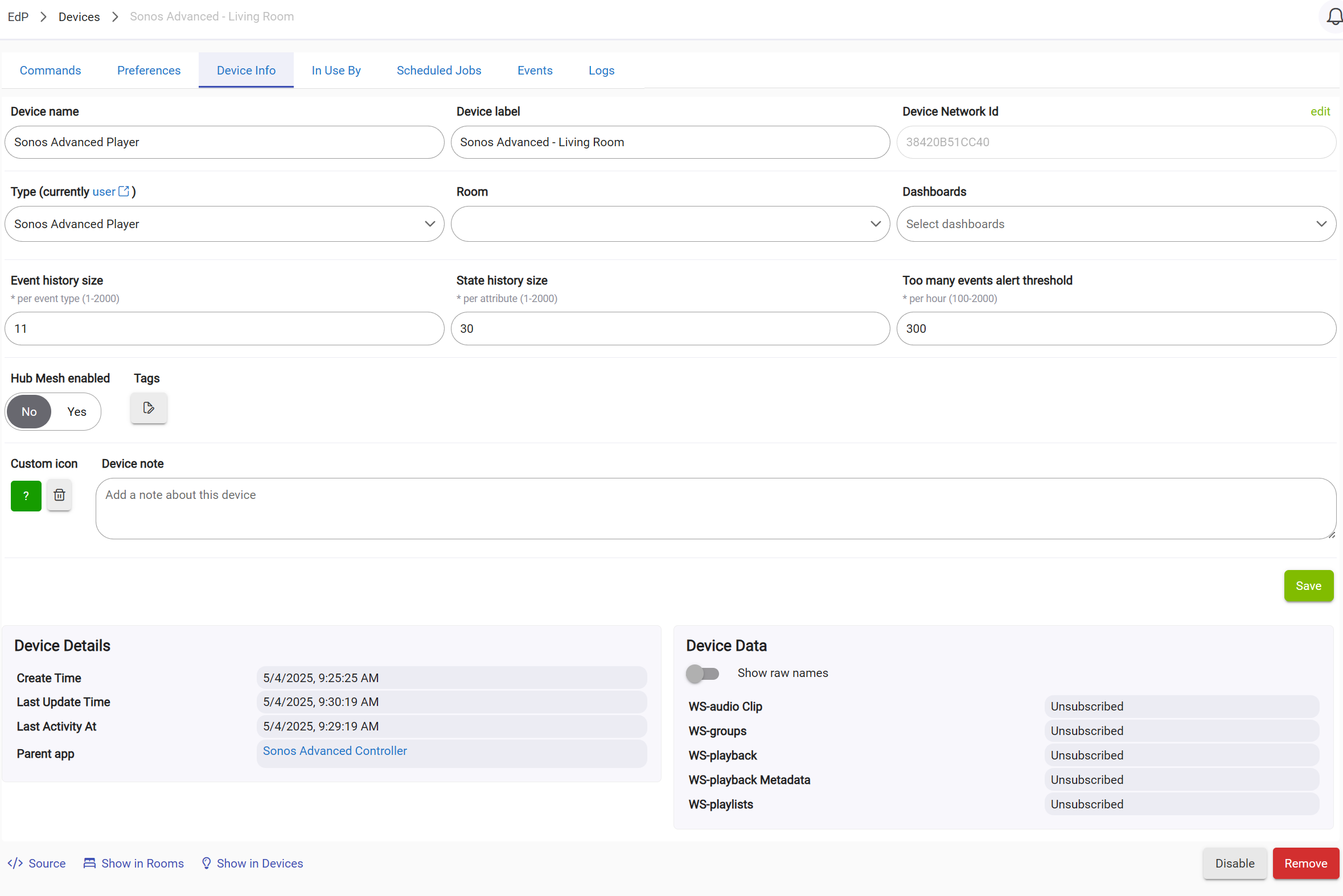

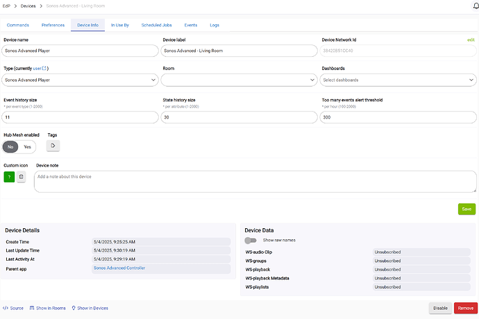

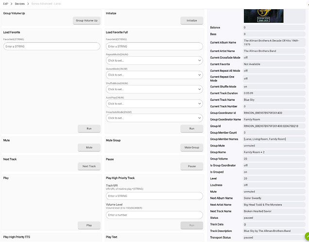

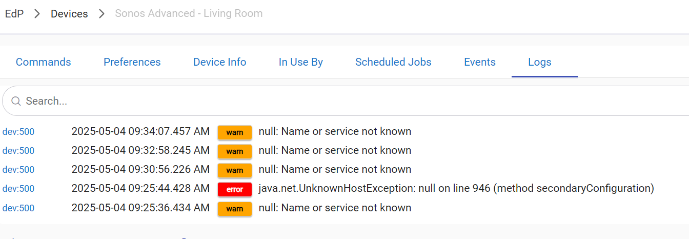

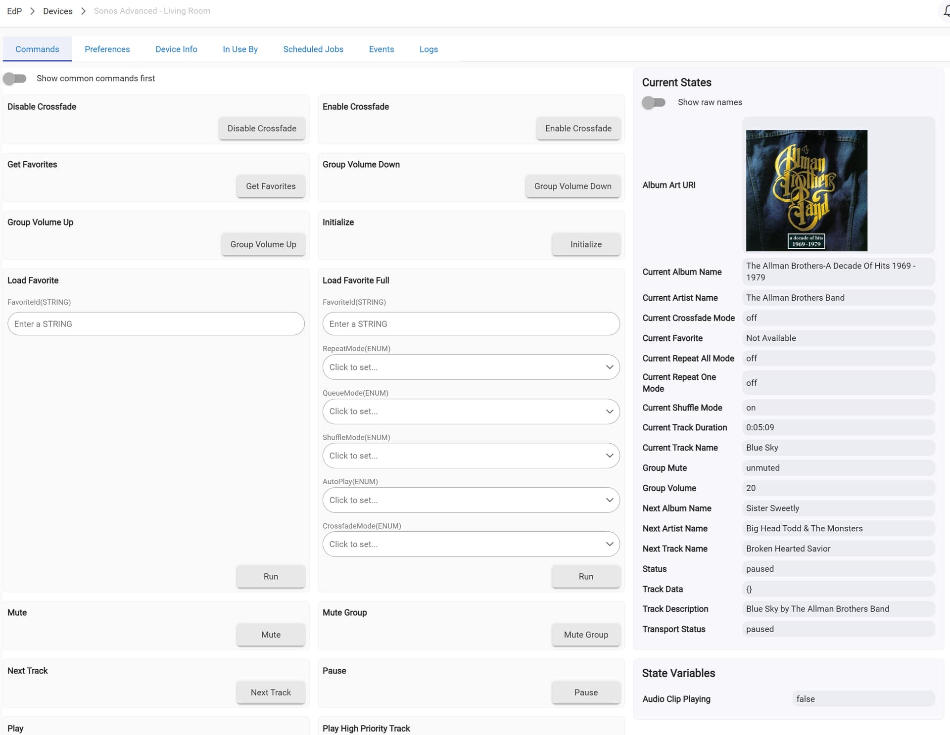

Hello All, finally cut over to Sonos Advanced Integration. Nice app! Took me a few tries to get all my speakers pairs found, but now have all 3 pairs as devices. Family Room, Living Room, and Lanai. Have initialized them all. Problem is that when I try to add all 3 pairs to a group, only FR & Lanai show up. LR does not. And when I got to the LR Device page it looks - different. See attached screen shots of the Command pages and Device Info pages (note FR and Lanai look the same).
For reference they are both Sonos One SL models. All work fine within my Sonos app. Commends from the Hubitat Device menus for FR and Lanai work fine. Command to LR do not.

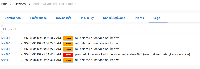

LR log shows:
I have tried deleted and re-adding LR several times. I'm out of ideas, so any suggestions welcome.

For anyone interested, I just kept trying and eventually got all 3 of my speaker pairs to show up. Definitely seems fragile.
The app seems to have issues adding more than 1 or 2 Sonos speaker child devices (regardless of pairs) at any one time.
I was able to get all of my Sonos speakers added by literally discovering, creating, and testing (using the TTS functionality) NO MORE than 1 or 2 speakers at a time.
This has the additional benefit of identifying the left vs the right speakers in a pair. (In identifying the speakers in the app as part of "discovery", there's no differentiation or identification of the left or right in a pair.)
Even adding 1 or 2 speakers (and resulting child devices) at a time can run into problems.

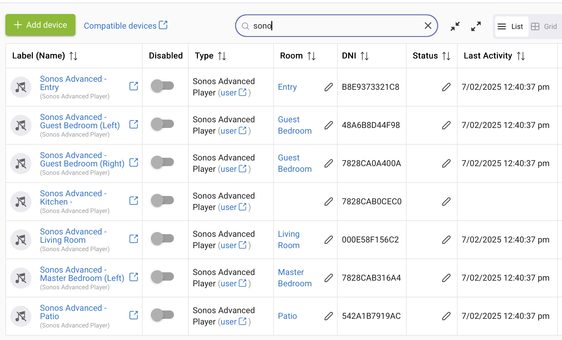

The easy way to see if a speaker was added correctly is to look at the "Last Activity" field for the device.
If the timestamp is "blank", the speaker WAS NOT added correctly.
See my "Kitchen" speaker in this picture for an example:
Another test to see if a speaker was added correctly is to try and update any of the device info. If you cannot successfully save the changes, the speaker was added incorrectly.
Manually delete the child device and go back through the Sonos Advanced app discovery process to try and add again.

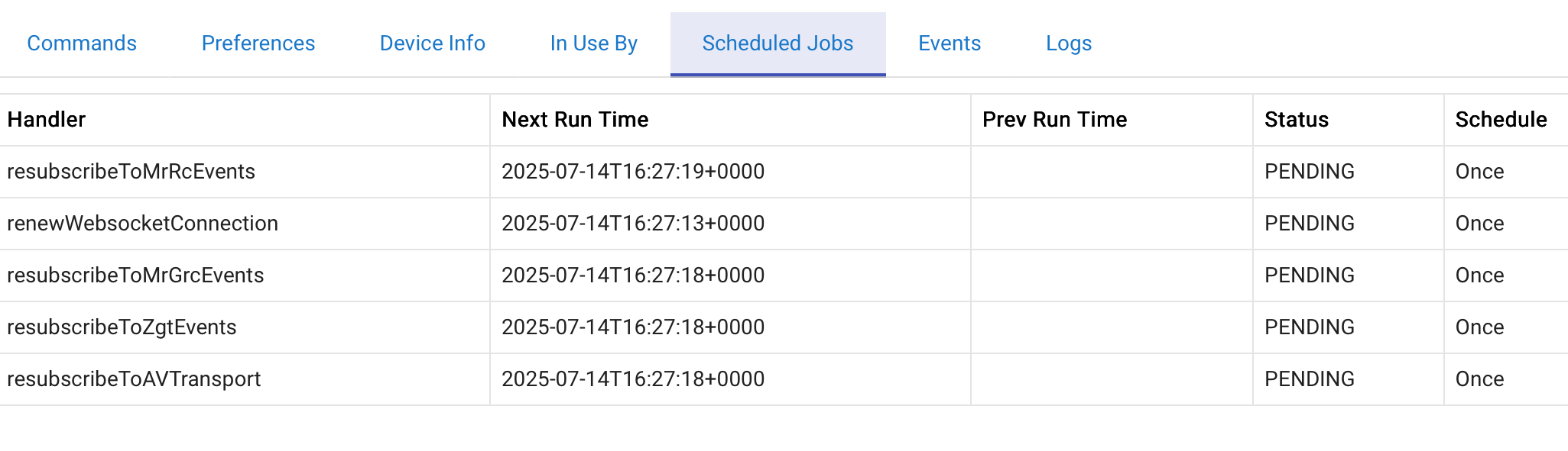

One advanced Sonos’ agenda always has an entry like:
The time increments 6 hours when the previous time is reached.
Any suggestions?

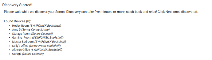

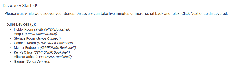

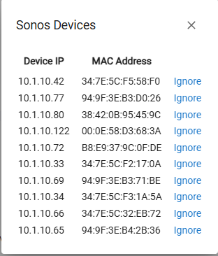

So I am having an issue. Hubitat and Sonos on same network, and it only discoves 8 of the 10 devices that I have. Is there a way to manually add the missing devices? They show up in my Sonos Phone App, and verified they are all on the same network, and all have a fixed IP addres.
Note: Built-In Sonos Intergrations Can find all 10 on the connect devices to you hub:
But the actual Sonos Intergration also only finds 8, How can I get the missing ones in?
Nevermind I just needed to reboot them and now they are found!. Leaving info incase other have issue

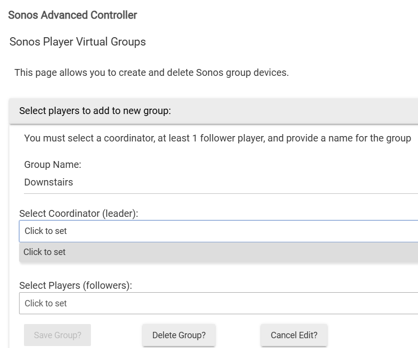

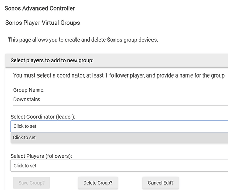

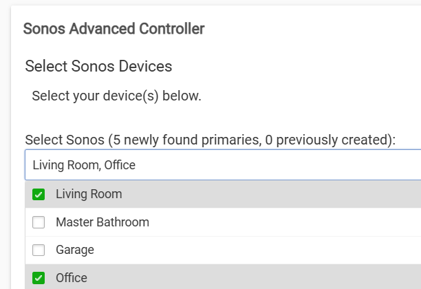

I rebooted my Sonos devices as suggested above and Sonos Advanced Controller was then able to discover them. Now I'm trying to create a group using the Living Room and Office Sonos devices (See Fig. 1). Now under Hubitat's "Devices" I have "Sonos Advanced - Living Room" device (See Fig. 2). But when I attempt to create a group under "Sonos Player Virtual Groups", all of the options are empty (See Fig. 3).
Am I missing a step here?

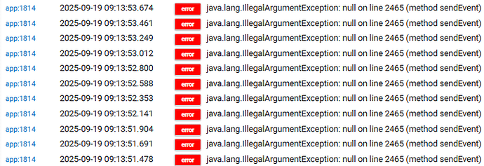

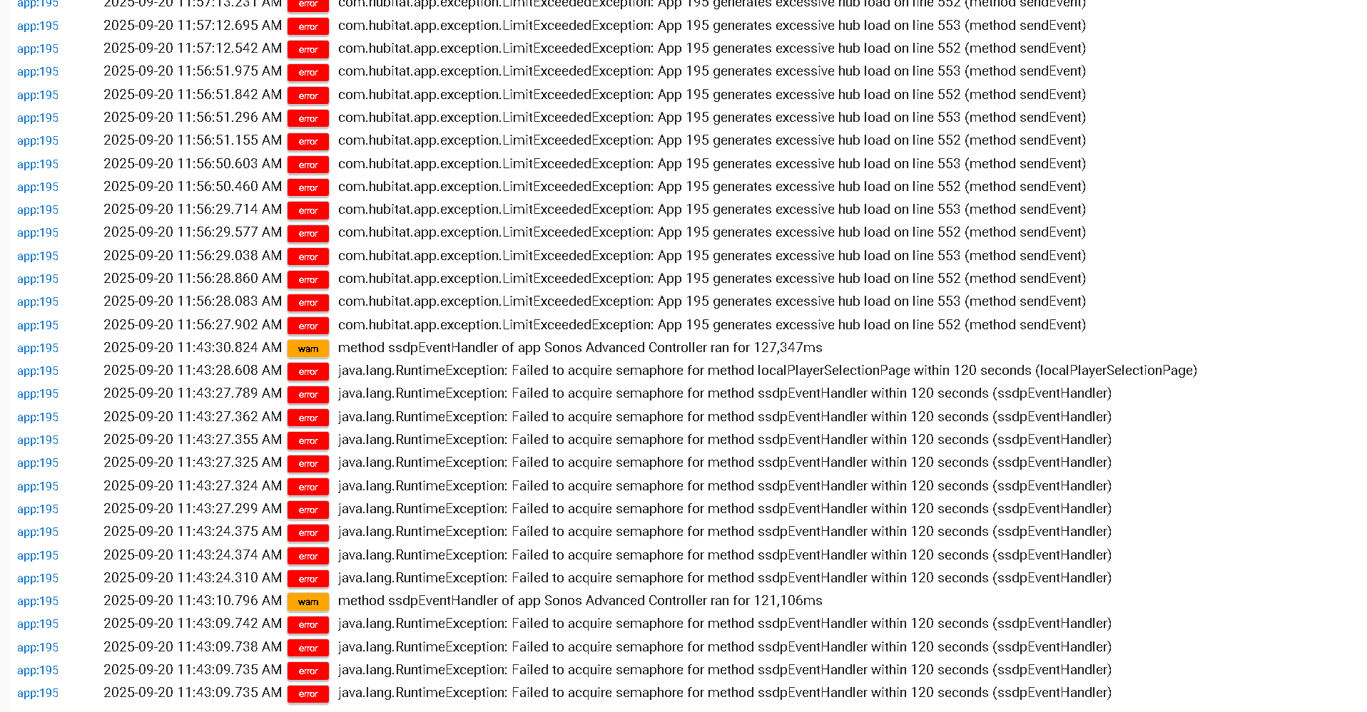

I have noticed an increase in errror messages in the logs related to this app.
Any ideas?
(Trying to troubleshoot Severe Load messages from HE)
EDIT - 19-Sep: Looks like this is still happening:
Can anyone provide some feedback?

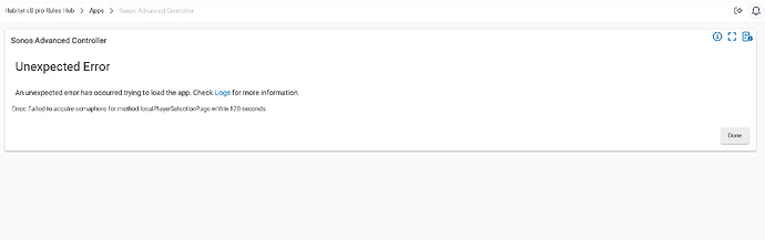

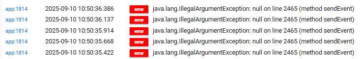

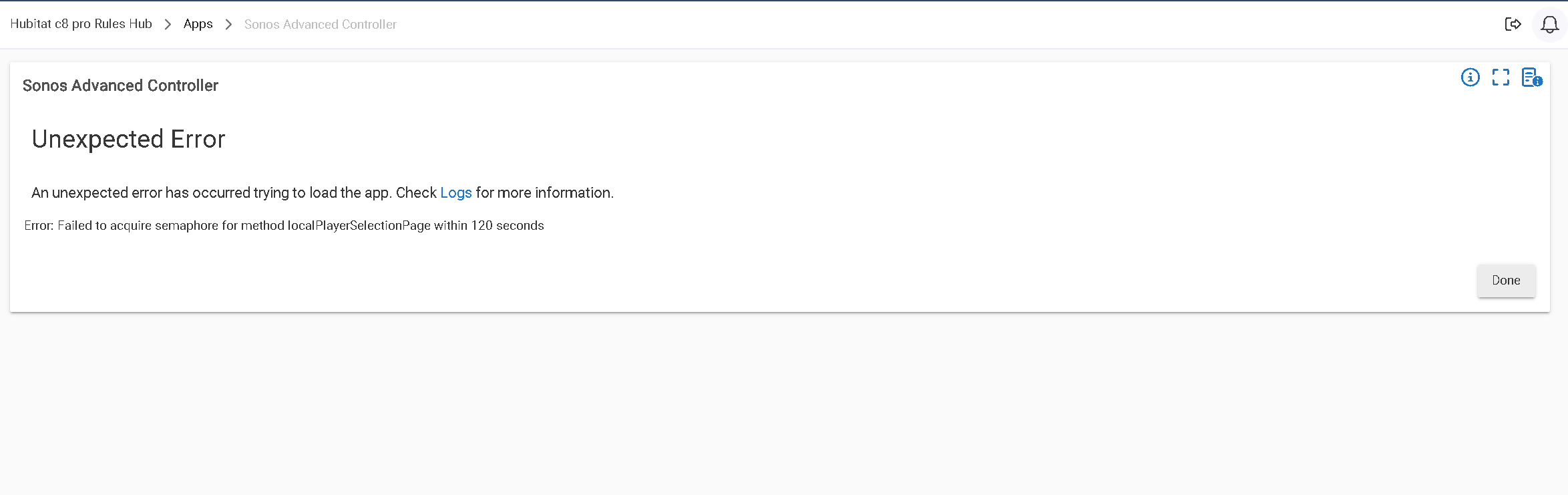

Has anyone experience when clicking next after discover they get the below error:
I have tried rebooting hub and repair from HPM but still the same error
Many of the below java errors in logs
I had the same error. I hacked the driver to put in some debug information and realized that this comes when a speaker sends information but you do not have a corresponding device. I.e., dni XXXXXB5D2FB4 (the MAC address without ":" or "-") is sending all the information for "Current States" on the command page for the device. In my case, the MAC was one of a paired speaker. I had created a device for the left speaker, but the right one was sending information. Once I went through the Sonos Advanced Controller discovery and created a device for the right channel, the errors went away because there was a device to "catch" the information. This was user error, because I thought the Left channel was always the main speaker, and the right channel was the secondary channel. If you go to the drivers code for Sonos Advanced Controller, you can throw in logDebug("dni ${dni}") before the error line and turn on debugging in the device to see what DNI is sending the unhandled information and lookup what device it corresponds to in the Sonos App (i.e., find the corresponding mac). Then create a device for it. Hope that helps.

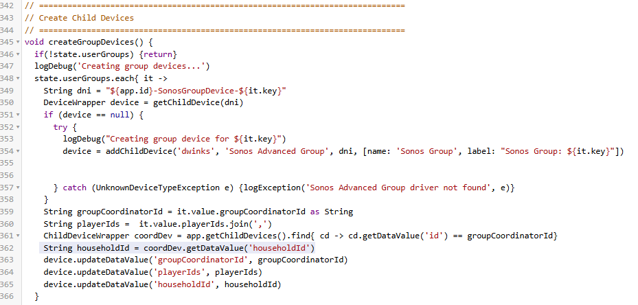

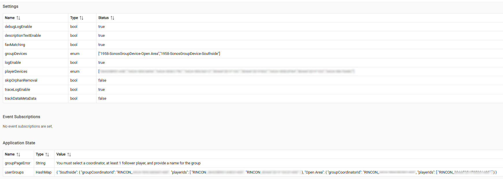

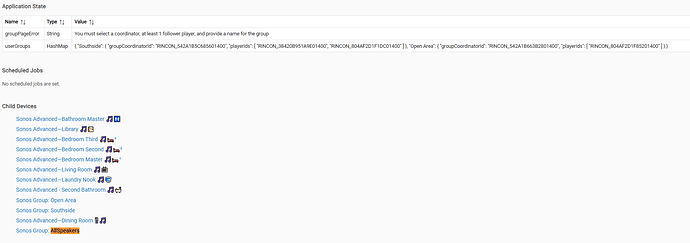

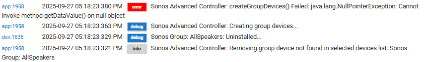

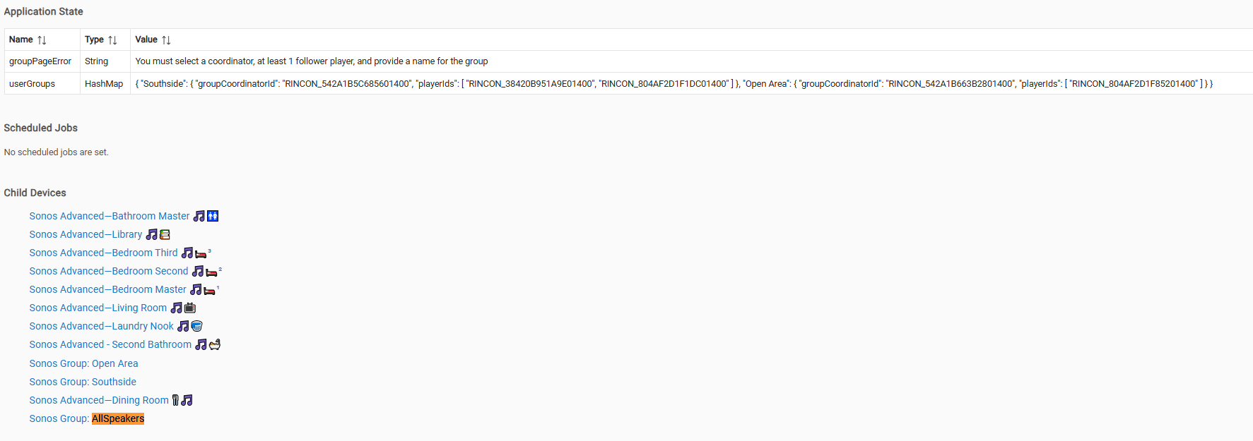

I'm having an issue. I previously created two two virtual groups, and they are working well. However, when I try to create a third the app errors because it cannot retrieve "householdId" on line 362:
I don't know where the app is getting this value or why it got lost. I tried repairing the Sonos Advanced Controller with the Hubitat Package Manager Repair option, but it did not help. Any hint on how to fix?

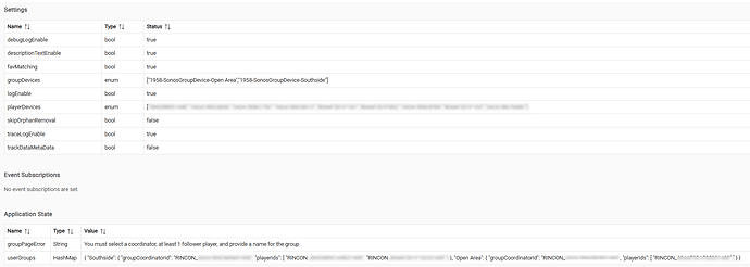

Edit: Actually, looking at the previous lines I see where the code is pulling it from. My devices do show the householdId in their Device Information page:
Edit 2: So, after the error, the child device is present and working (issued a TTS), but not listed in the groupDevices, so the controller ends up deleting it when I exit.
Edit 3: I just hard coded the householdId, and everything looks good. See below. When I get a chance, I'll see if I can figure out why the call to get the information from the coordinator is failing.
Seeing a lot of events with the Sonos Advanced Controller, which may be contributing to the Severe Load and Elevated Load alerts.
renewWebsocketConnection and resubscribeToZgtEvents methods starting within a few minutes of the severe load alerts
Any ideas or suggestions about this?
