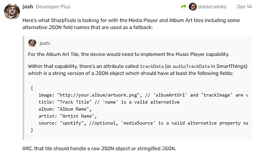

The regression from the update on 1/14/24 is still present. At the time, the trackData attribute was presented in "name":"value" pairs instead of the name=value format that attributes is using now. webCoRE cannot parse this format and it's not working with SharpTools either.
See this post and those surrounding it for more.

Got it... simple fix. 0.6.1 out with that.
0.6.1: Jsonify trackData for SharpTools/WebCoRE. No other changes.

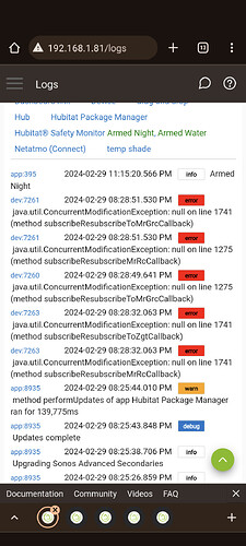

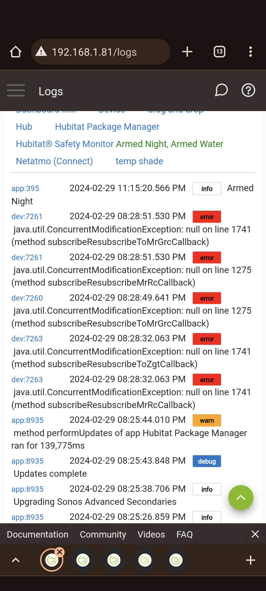

This was the events just incase it's useful
Yeah, I saw that on my C7 earlier for one of those.
I think I'll need to put an explicit semaphore around those subscribe methods. Seems like HE is running multiple instances of the driver if I turn off 'singleThreaded: true' on it and that's the one spot where it complains.

0.6.2 added semaphore locks around getDataValue/updateDataValue calls. This should prevent any of these concurrentModification exceptions.
No other changes on 0.6.2.
