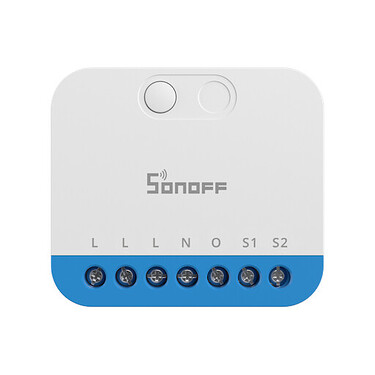

I recently got a Sonoff Zigbee Mini Dimmer with power metering (MINI-ZBDIM). I couldn't find a driver that fully supported all the features I want (although I like to write my own drivers, so I didn't look very hard), so I wrote this one. It's working well for me, but if you have any feedback I'll try to update it with improvements or fixes.
