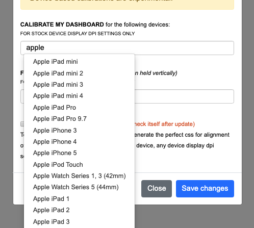

  • settings - screen calibration and smartly dashboard global settings
  • zoomy (advanced) - can't find your device in 'calibrate my device'? we've thought of that.

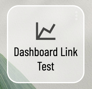

clock using zoomable mod, dashboard link (left) using buttonize and icon_only mod
dashboard link using 'buttonize' mod

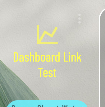

dashboard link using buttonize mod, background color (transparent), text color yellow, border color transparent

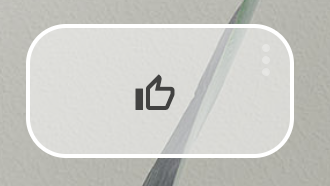

  • Add ability to change 'dashboard link' tile icons, change/hide text #61

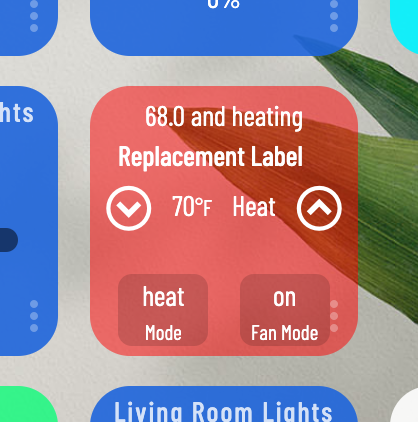

  • Update thermostat tile layout smartly-base #10

  • centered thermostat label by default

  • 'color bulb' type tile icon replacement is ignored #49
  • blank line added to top of custom CSS each time updated #48
  • 'button' type tile icon replacement doesn't work #47

  • thermostat now allows label replacement. #39
  • thermostat design updated for square-tile HEAT and COOL. [AUTO requires 2x wide tile]. #39

Oh yes, the reason that looks strange is because the 'dashboard link' tile type is designed to stand out from other tiles by taking up 1/2 the available row height, centered vertically. This would come in handy when visually setting a row of dashboard links along the top or bottom of your dash.
An alternative, if you really would like your dashboard links to occupy the same real estate as a normal tile, is to create a 'link' type tile and manually enter your direct dashboard URL.
