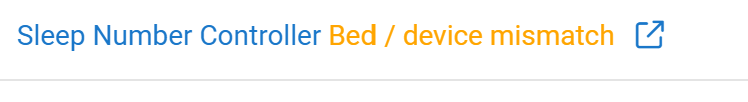

Does anyone know how to fix this as I when in the app and make some changes and it came back online but few minutes later came back Bed/device mismatch and I have no idea what to do next?
Can you bump logging to debug and then provide the output when you force a refresh?
I work on it last night and redid the app and set the beds back up in the sleep by Number app and when I when to bed last night it was not working, but this morning it is back online and working ok now. Thanks

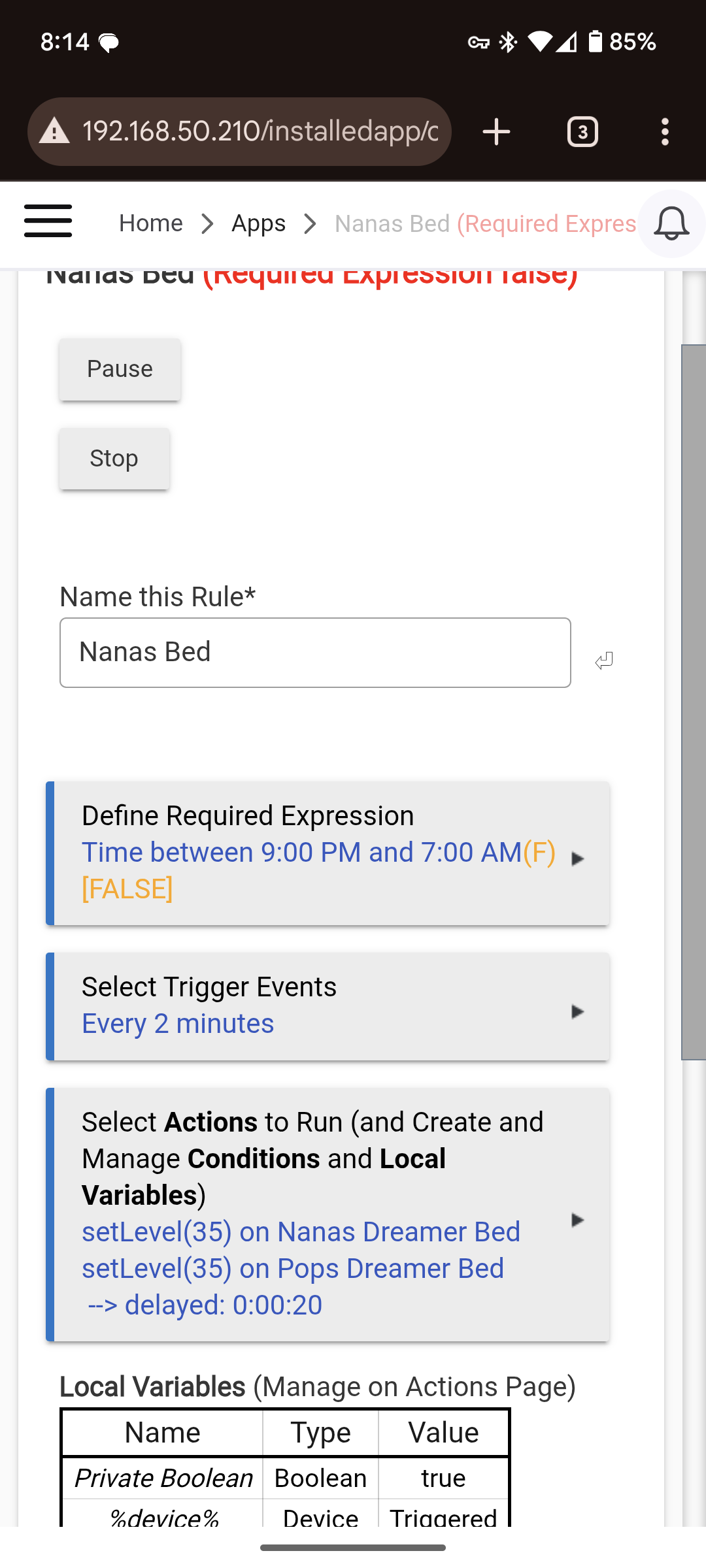

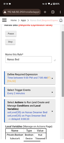

New SN bed in the RV 6 weeks ago, my wife's side won't hold air so while I wait on a new pump and hoses I setup a Rule Machine rule to help
It seems to keep up pretty well during sleep time, however during heavy activity it doesn't keep up and here is where it confuses me.
Every 2 mins it triggers and I can hear the pump turn on, however it shuts off within like 3 seconds (like it does during sleep) yet the bed is not back up to 35.

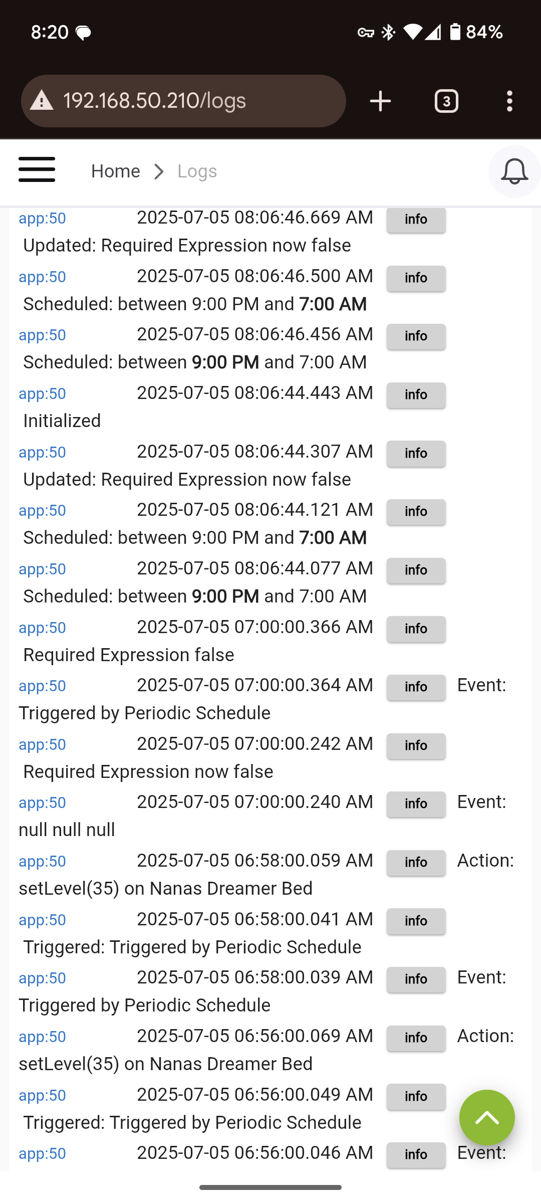

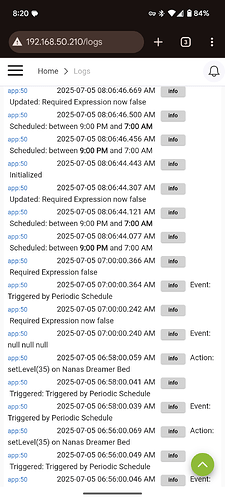

Logs show 2 mins triggers and setting the bed back to 35.
When I manually trigger a new number from the apps, it seems to work fine

yes the logs show 1 side b/c I just added my side to the RM Rule

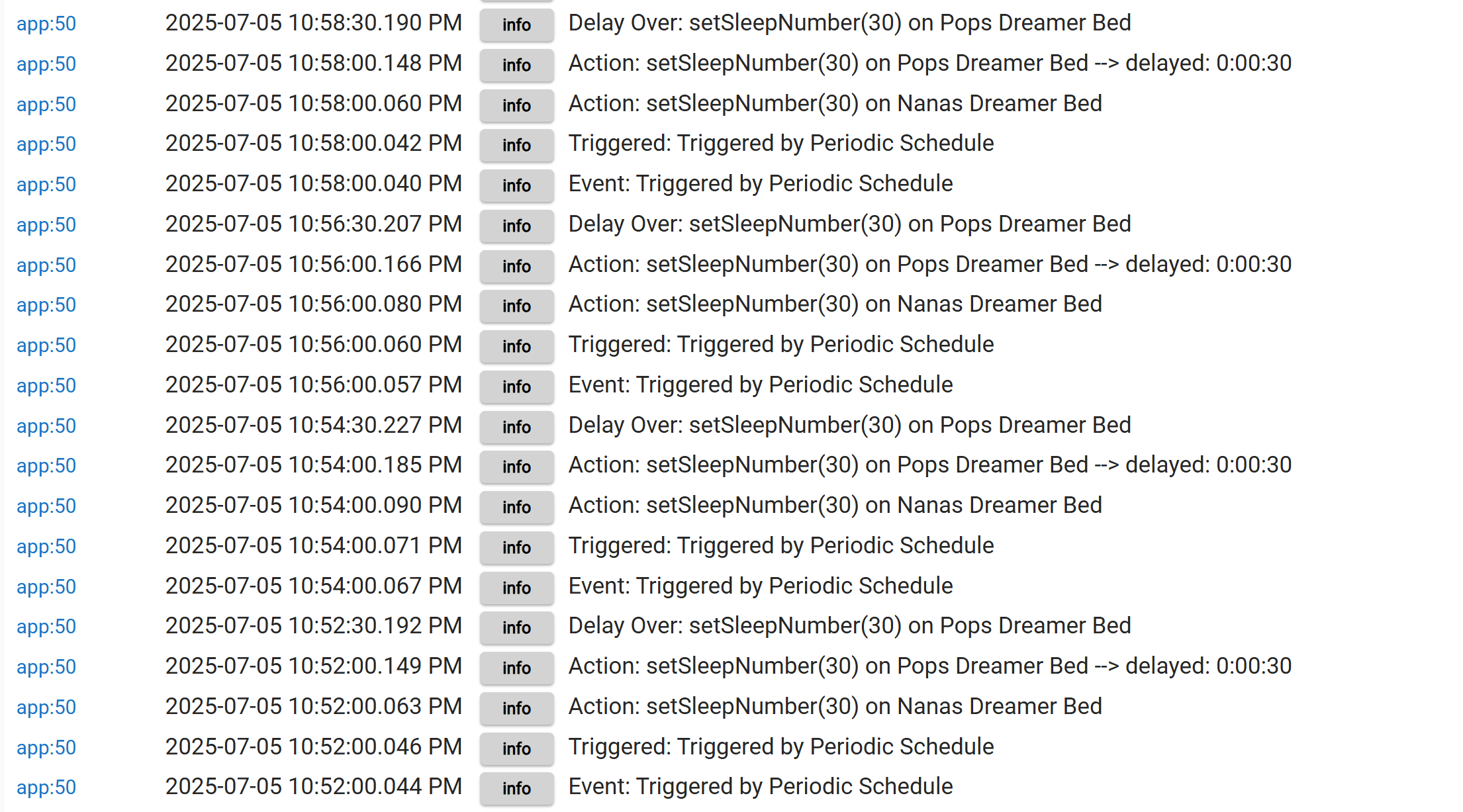

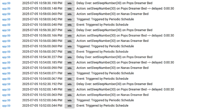

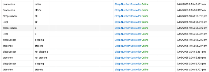

For instance, last night with both sides in the rule, which starts at 9:00, went to bed at 10:56 and you can see the Rule has been running every 2 mins
After getting into bed, it felt like my side was down, got up, logged into the SN app and it said my side was 5, not 30. After pumping it up again, the rest of the night was good.
Seems like we have experienced this before where Hubitat says one thing and the SN app shows something else.
Here is the Device Details log that shows a setting of 5 when we got into bed when it should have been 30 since 9:00pm per the rule
